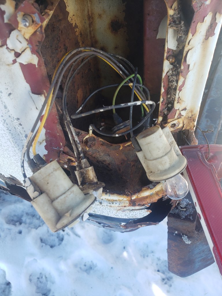

OP the screws that hold the tail lights are #8 and 1 inch long, if you end up stripping or ruining any in the process. If you needthe things that they screw into, harbor freight has U nuts in a kit with #8 u nuts but you would need to buy screws separate. I used phillips since I just neeeded SOMETHING of the same size/head type to replace mine. I had square, torx, stripped out ___, phillips, standard, and hex along with rust on mine. lol.
your sockets look different but heres the ground mentioned. see the wire on the bed?
