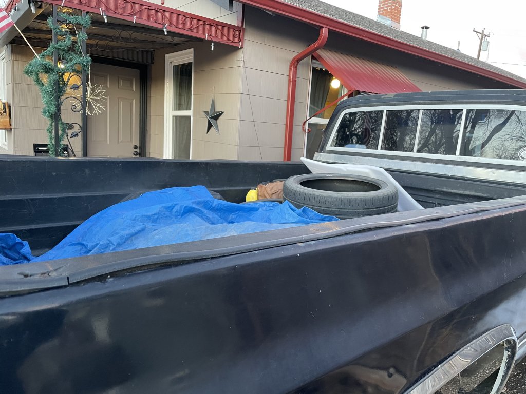

I have an 83 Chevy K20 long bed, it currently has a pre fab pop in plastic bed liner that is warping and I have no clue what condition the bed is under it yet. I plan to pull it out with the next load of stuff I take to the dump. I was thinking I should replace it with a DIY spray in liner. Looking for thoughts on doing that to this year of truck, best spray liners to buy, alternative suggestions and what to use if it’s rusty (rest of body and interior has no rust but who knows‍♀️)? Please let me know your thoughts!

Here’s a pic of the bed right now

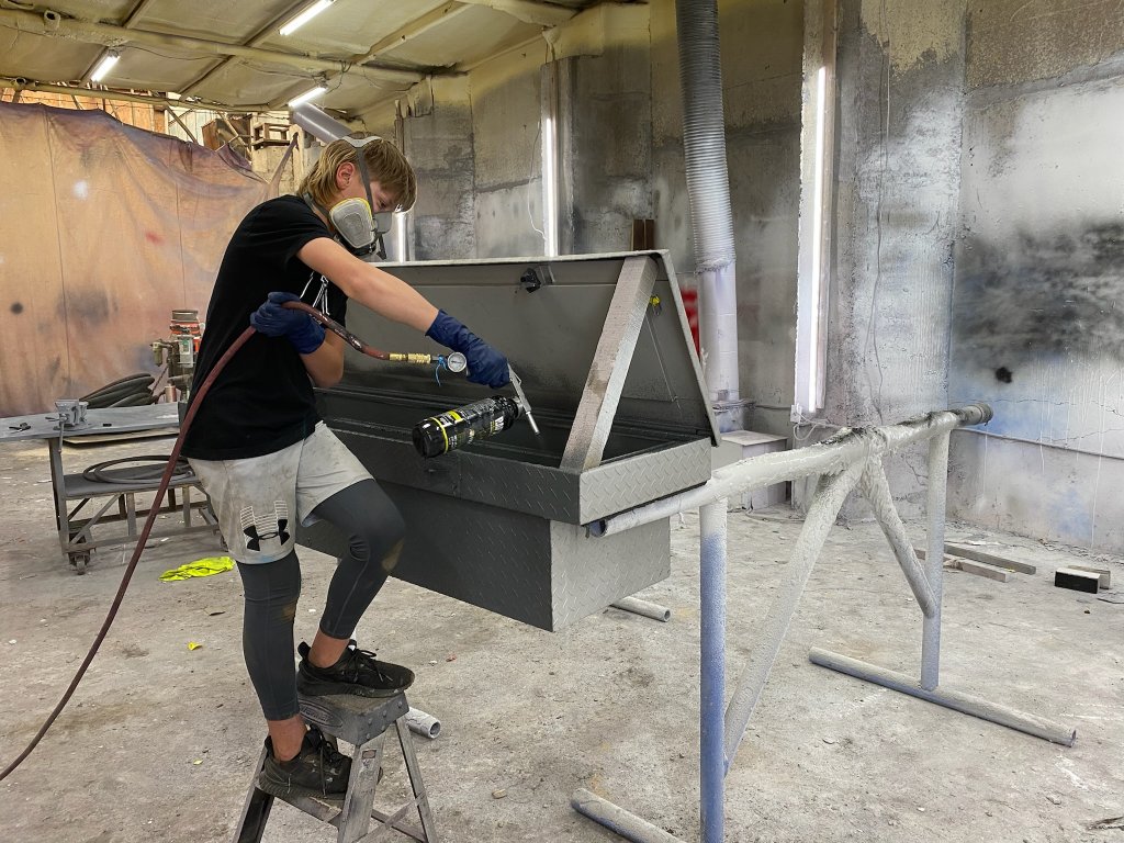

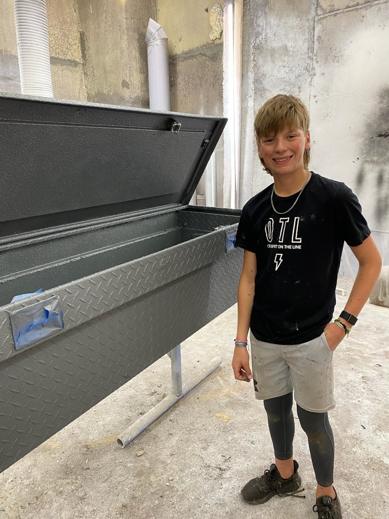

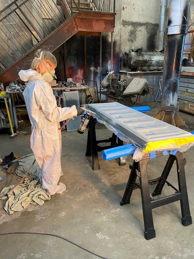

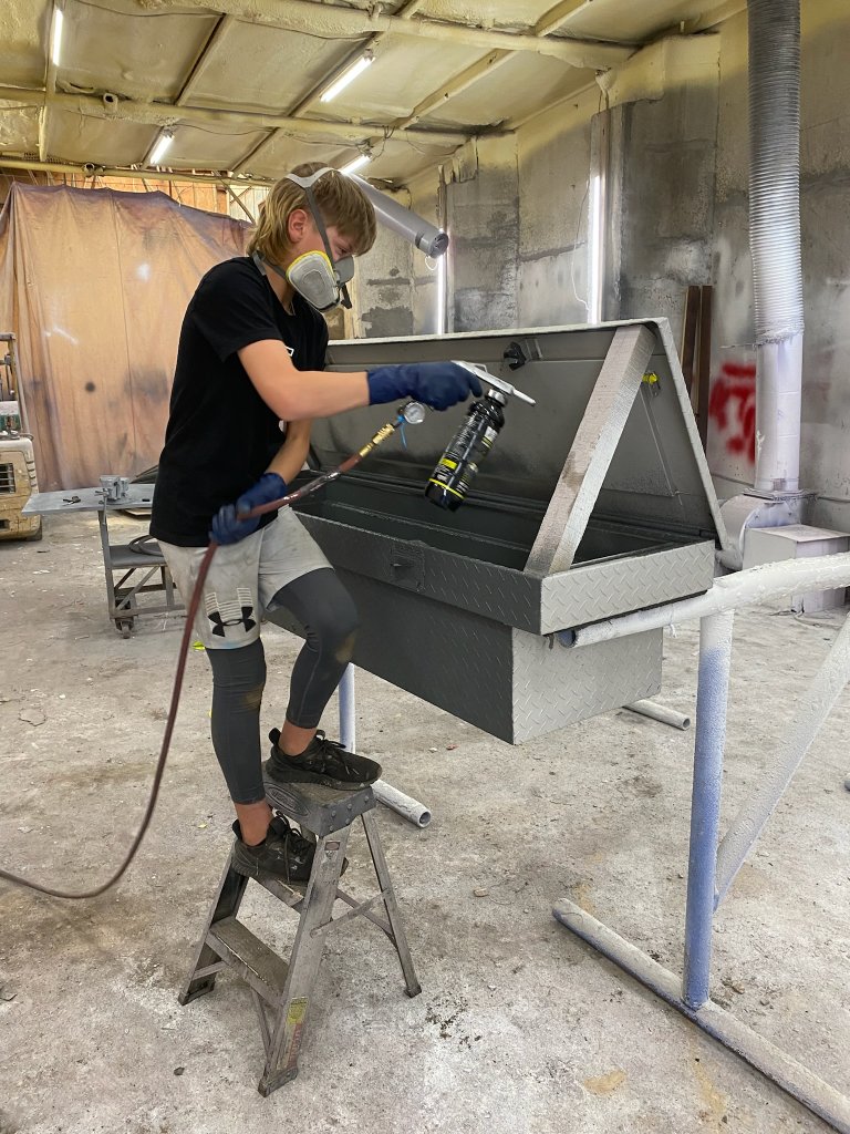

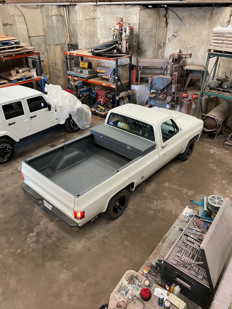

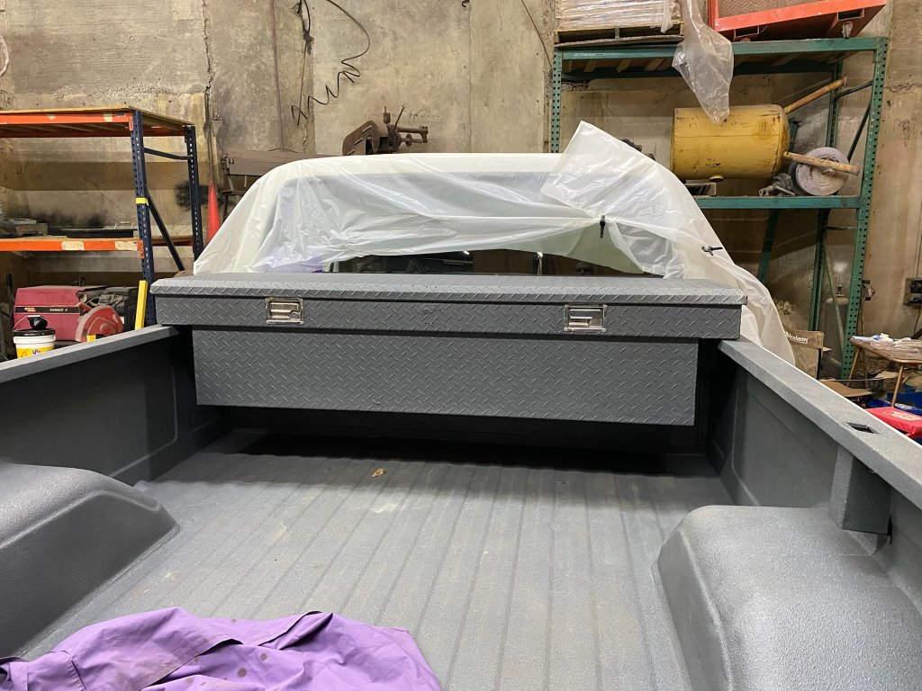

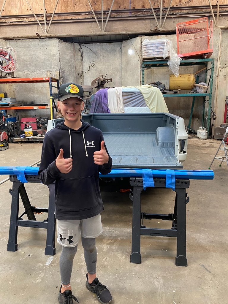

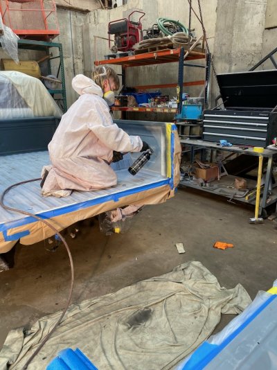

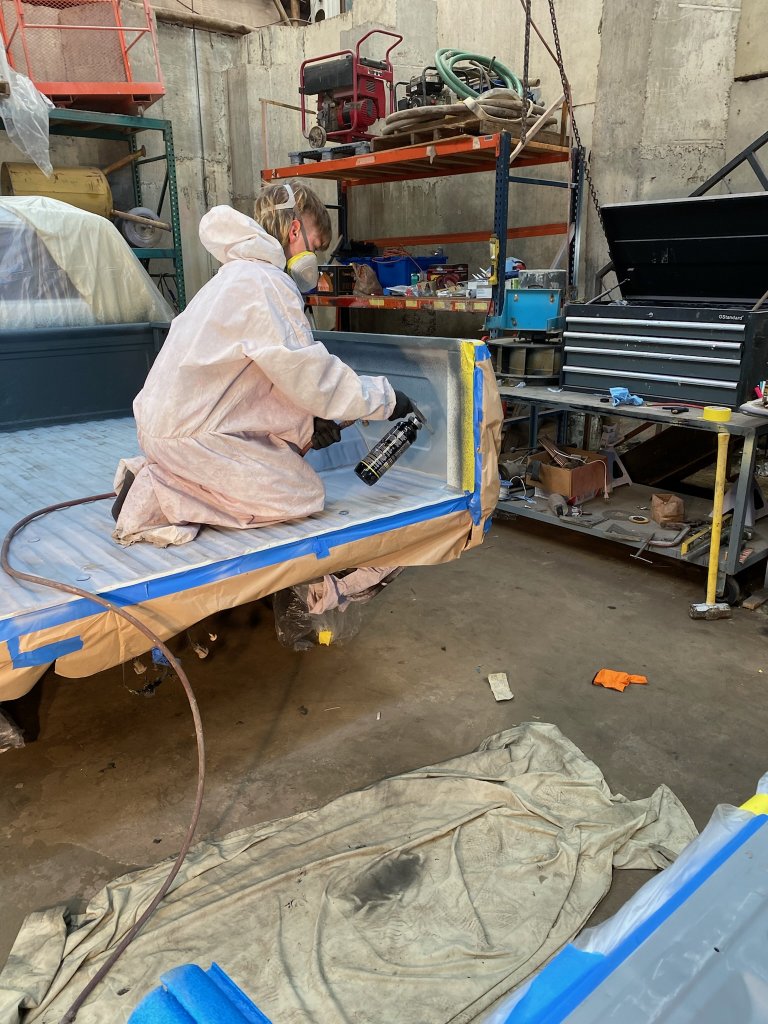

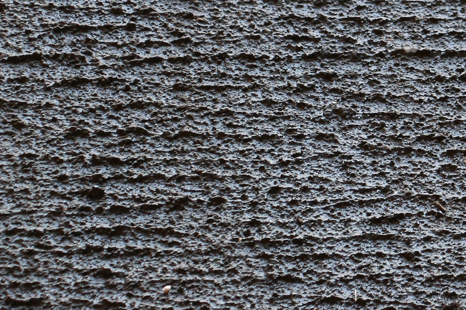

we agree with Thomas… Raptor 100%. Great DIY. My son (15 years old) did his bed and then toolbox.

I think his smile says it all!
