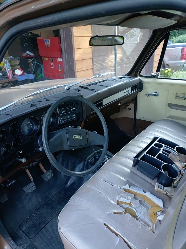

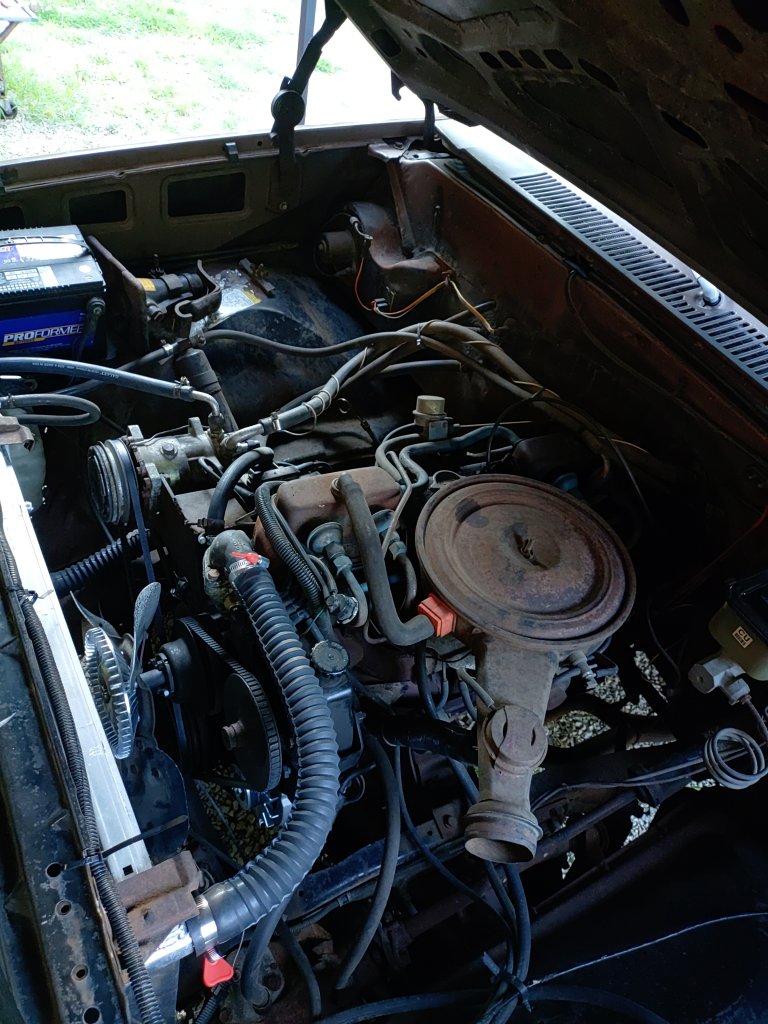

Hello all! I've got a new to me 71 C10 250 NP440 truck with add-on air conditioning. I'm wondering if parts are available in the event it does need repair? It's got a fabbed bracket for the Sanden 509 compressor, as I'm sure the up fit one was broken long ago since it's install in 1983 (have the paperwork from the Texas install). It does work and is very cool, but the ducts will need some love later.

Typically those old "dealer installed" A/C systems used generic off the shelf parts. You can see even the hoses are made from parts using hose clamps instead of crimped fittings. You already know what compressor you have. The receiver-dryer is a standard unit but you may have to look at dimensions in a catalog to figure out which one you would need. The expansion valve will be for R134a instead of R12 now and you just need to get the bulb length close and the fitting sizes. The condensor will be based on dimensions and fittings. The hardest thing will be the evaporator. Again, just need to find it by dimension.
