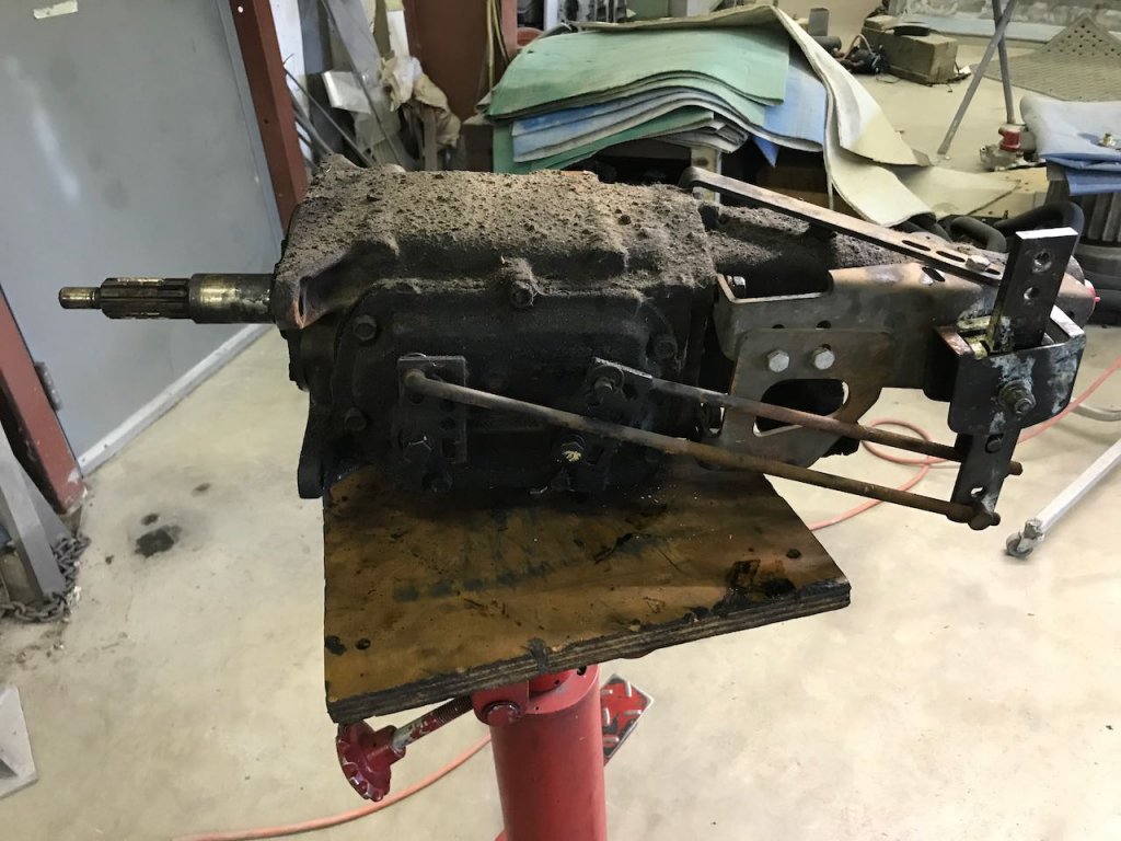

Anyone running a muncie or saginaw 3 speed have pics of your shifter setup?
I have a Saginaw 3 speed on the tree in my impala.
Whatcha need pics of?
justhorns
Jun 1, 2022
236
609
Denver
Does this help?
