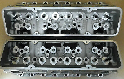

Rusty Nail
Victim of Culture
Jan 29, 2015
8,415
7,068
Your mom's house
Rusty
1977,1988
C20, K5
350, 350
25,788
14,228
You cant go wrong with AFR. If you have ever seen the Engine Masters show, they always perform at the top of the list.
Have they run those cheaper ones yet? I can't remember. And by "cheaper", I mean "less expensive than previous AFR offerings".
SquareRoot
Mar 18, 2017
2,022
2,709
Arizona
85
Yes. I think they were Patriot brand. But for outright bang for buck the AFR 195 for street use always seem to come out on top. If you mean a less expensive AFR head, I'm not sure.
Rusty Nail
Victim of Culture
Jan 29, 2015
8,415
7,068
Your mom's house
Rusty
1977,1988
C20, K5
350, 350
Nah , they have intent to make a cheaper head m pritty shure.
