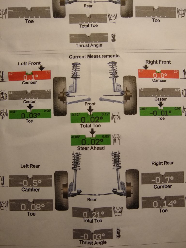

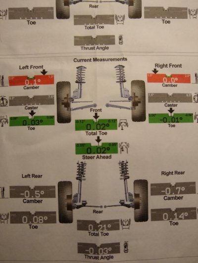

good call, how much you wanna bet the guy who did the "alignment" has a ferret mustache and acne and also is the best alignment guy out there, he knows what hes talking about.Should be ok, but there isn't any caster measurements??
Are you confident that it was bad parts and not improper procedure? I know that replacing the ball joints on a 10 bolt calls for slightly goofy torque procedure. Lower ball joint nut gets torqued, adjusting sleeve for the upper ball joint gets torqued, upper ball joint nut gets torqued, then the lower ball joint gets torqued to the final spec.They did the ball joints replacement twice because of bad parts, no questions asked.
The axle could be shimmed relative to the leaf springs to change the caster, right?V=4wd=straight axle=no caster adjustment. Toe and go.
The way my K20 rides, I'm lucky the tires touch the ground as much as they do. I'm too busy trying not to spill my "open container" let alone worrying about caster/camber. If it were a C20 it would be a different story. With the price of gas now it doesn't matter anyway.@SquareRoot ,A couple of different ways to adjust Camber and caster shims for the leaf springs. That was the old way....set the toe and let 'er go. NEVER was the right way to do it!! @Grit dog is right, the camber is good and it could use a bit more toe. You never know what the caster is unless it's printed out on the alignment results, but if it goes down the road good, the battle is just about over?
I think the camber spec is looking For it to be between 1 and 2 degrees while he has almost none on both sides.To be fair, it would be tough for caster to be “off” on a straight axle leaf spring truck unless the axle was shimmed for driveshaft angles on a big lifted truck. Or otherwise bent up or spring perches modified. And if it was excessively high or low it would be noticeable.
The rest of the numbers are fine/perfect. Just a dab of positive toe is right. And camber is perfect as well. 0 or 0.1 is insignificant.
@bucket ....handling....really Andy?..we are talking 4wd here......lol.. There are shims for camber changes that go between the spindle and axle housing that I have used for YEARS and also different degrees of sleeves to use on the upper ball joint. The shims work very well, better than the sleeves IMO. Never seen offset ball joints for a K series?Negative camber can be beneficial for handling characteristics on an IFS car, but certainly no use on a solid axle 4x4.
