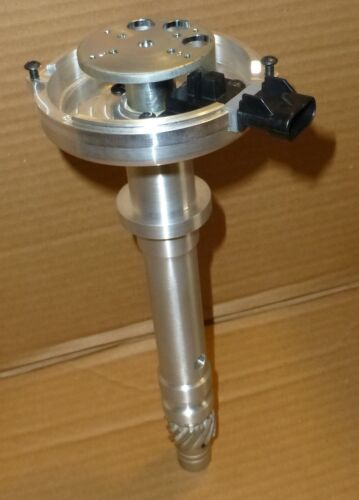

This is the one I think was mentioned before:
Wow, that is a very nice looking, and looks to be a very well built distributor, I like that it is not all plastic! This one may be worth the investment.
