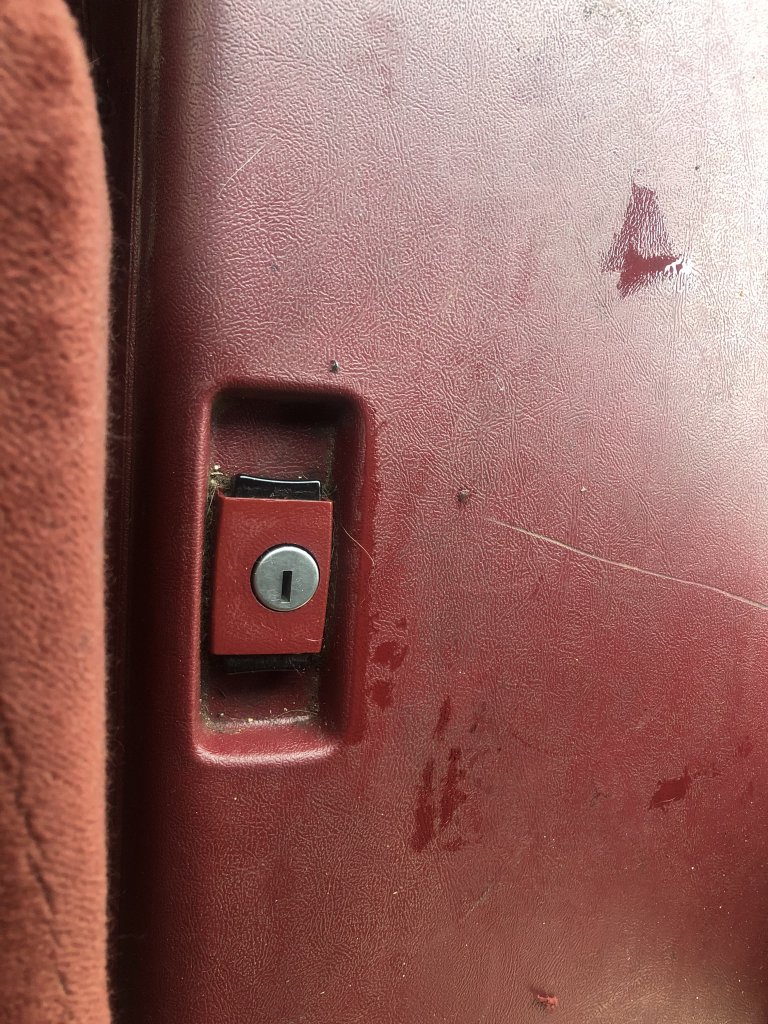

Greetings. Slowly but surely, my son and I are checking off repair/upgrades from the list.
All the mechanical stuff is done, now it’s on to the crap that has deteriorated during its 20 plus years in “dry dock”.
We can’t get the center console open. The buttons are stuck in the depressed position, the key just spins in the cylinder. Before I break it, I’d like to have a replacement on hand. I have ZERO problems with replacing it, when we got the truck there was something really nasty growing on it. The plastic is bubbled up and discolored.

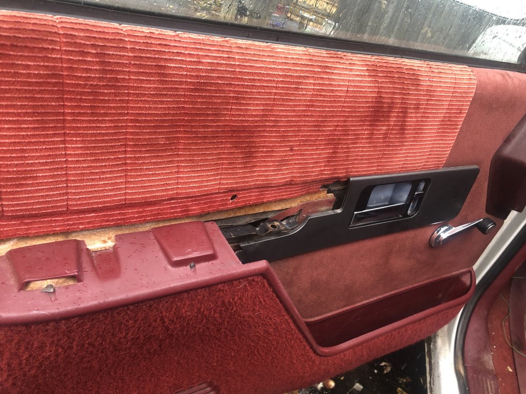

Next items, drivers door panel. The panel is pretty busted up, especially in the interior pull handle area. This is a manual window/mirror/door lock truck, but wouldn’t mind “upgrading” if needed.
Both exterior mirrors are junk. The glass is missing on the passenger side, both frames are sloppy loose. Around 60mph, the drivers mirror folds in by itself. I definitely wouldn’t mind putting power mirrors in this, simply to make it easier for my wife to occasionally drive this if needed.
As mentioned, power windows/door locks would be nice. This is a 2 door Yukon, what’s out there?
Thanks in advance. My son is having a blast bringing this back from the dead. I’m having a blast teaching him.
S10, S15, Sonoma, Lumina APV, Silhouette, Trans Sport and Aztro/Safari used those same latches.
Your door panel actually looks pretty nice. Especially the condition of the fabric. It can be hard to find a decent arm rest pad in good shape, BUT, I have found out that the rear arm rest pads from a '92-'94 Suburban or a crew cab are nearly identical and they aren't beat up as often. The differences are so minor that they fit right up and look correct.

That center console id spay pb blaster in the key hole and keep workin the buttons and key to see it they pop back out. May need to wack it a bit to persuade it lol
