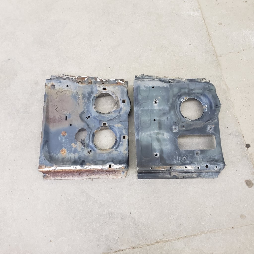

Oh, I guess one more question then, what about an 1987 pickup to 1989 suburban grille swap? Much closer years, same make? I just think the 4 bar styling of the pickup is more (Subjectively) handsome than the 'burbs. If not, no issue I guess, but thought I'd ask while you're here.
I also noticed this different style for the 89 year: What's up with that? I'm new to this stuff. The one I'm looking at is a "Trail Boss" model, What does that entail? I hear its a slightly more rugged version?
That the grill i had. So happy to remove. But I did it the hard way cause there's nothing but rusted out rad supports around here.
