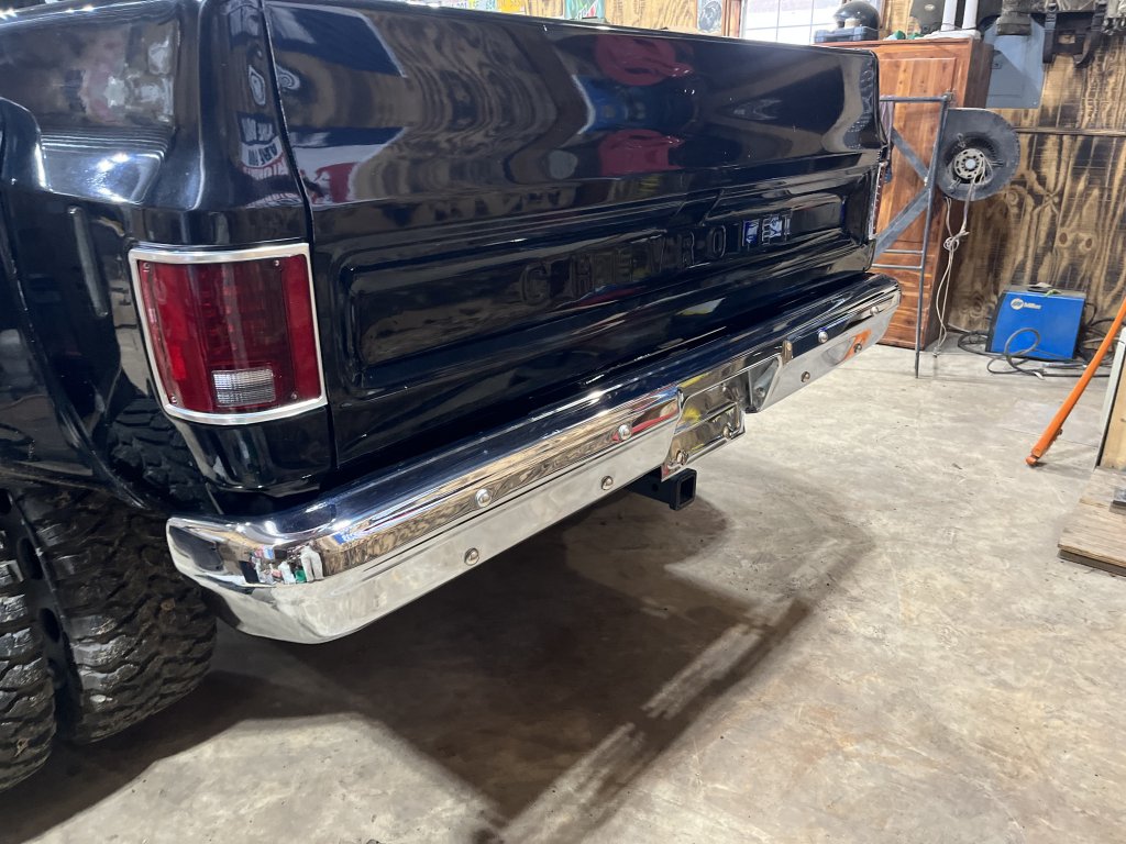

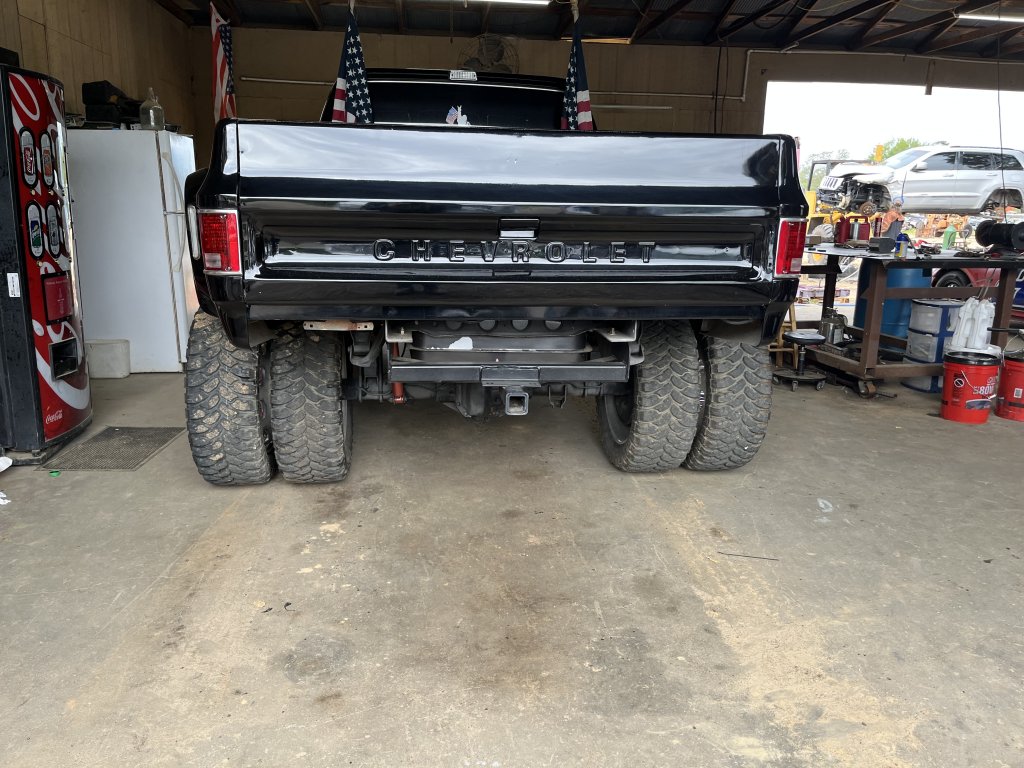

Heres mine...
A little faded, but not bad. Made a custom 2in receiver hitch too.
