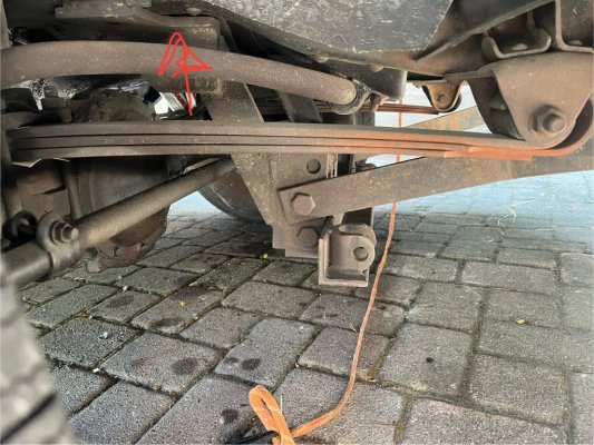

Just replaced shocks and steering stabilizer. Observed, after I lowered the truck back to the ground, that the front leaf springs on my 86 k20 4x4 (former plow truck) are arched up slightly.
Is this proper or are they simply shot?

That's normal.

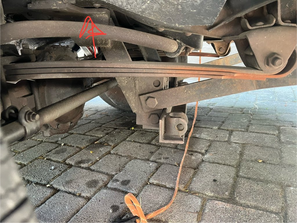

After I wrote this I realized I hadn’t been that clear. When I think of leaf springs, I typically think of rear leaf springs having a “big smile.” My fronts tho, have a slight frown.
Factory front springs are shaped that way. Although, those look to me to be aftermarket replacement springs. The individual leaves will typically have a beveled or rounded edge. Those look squared up, but it could just be the photo.
Anyway, inverted arc is the factory shape. Your plow will make the arc more pronounced.
