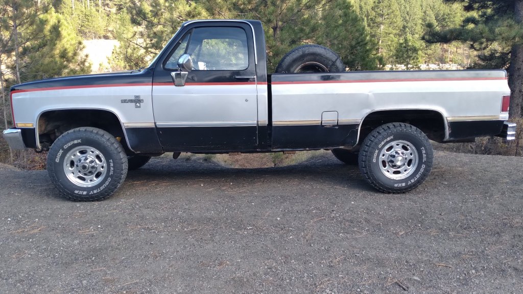

I did a 2" Add-A-Leaf on the front from Suspension Connection. It definitely will make it ride a bit firmer, but gives it a nice, suttle lift.
