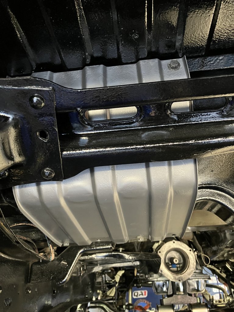

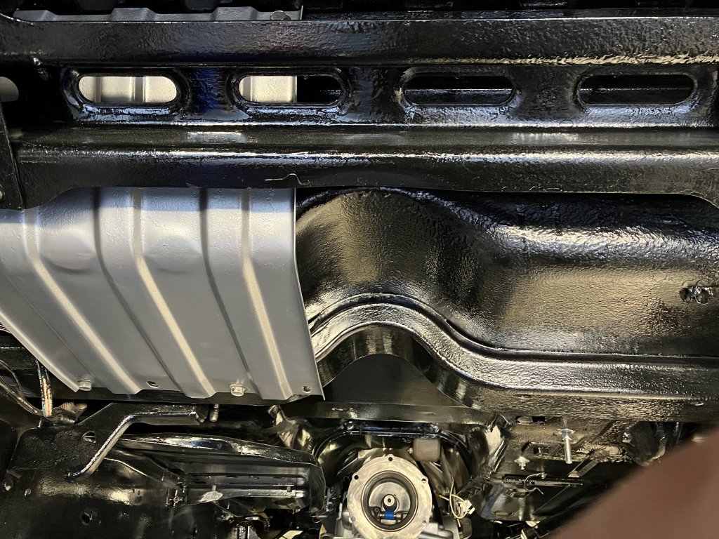

1983 Blazer: I am in need of a factory muffler heat shield for the right side for dual exhaust. I’m assuming that my Blazer originally didn’t come with dual exhaust and is the reason it didn’t have a heat shield for the right side. I’ve been looking online but can’t find one. I’ve checked AMD, LMC, Motor City K5, Brothers Trucks and Dynacorn but is not offered. Anyone have one for sale or know where I can find one short of a junkyard? Any other recommendations for a heat shield if I can’t find a factory one? Also, is there any point in keeping the catalytic converter heat shield, if not required for emissions testing. If there’s no need for it, I want to remove it but will be difficult since the bolts go in from the top of the frame and won’t come out unless the body is lifted. I’ll have to cut and drill the bolts out from the bottom. Just wanted to pose the question before I punish myself. Thanks y’all!

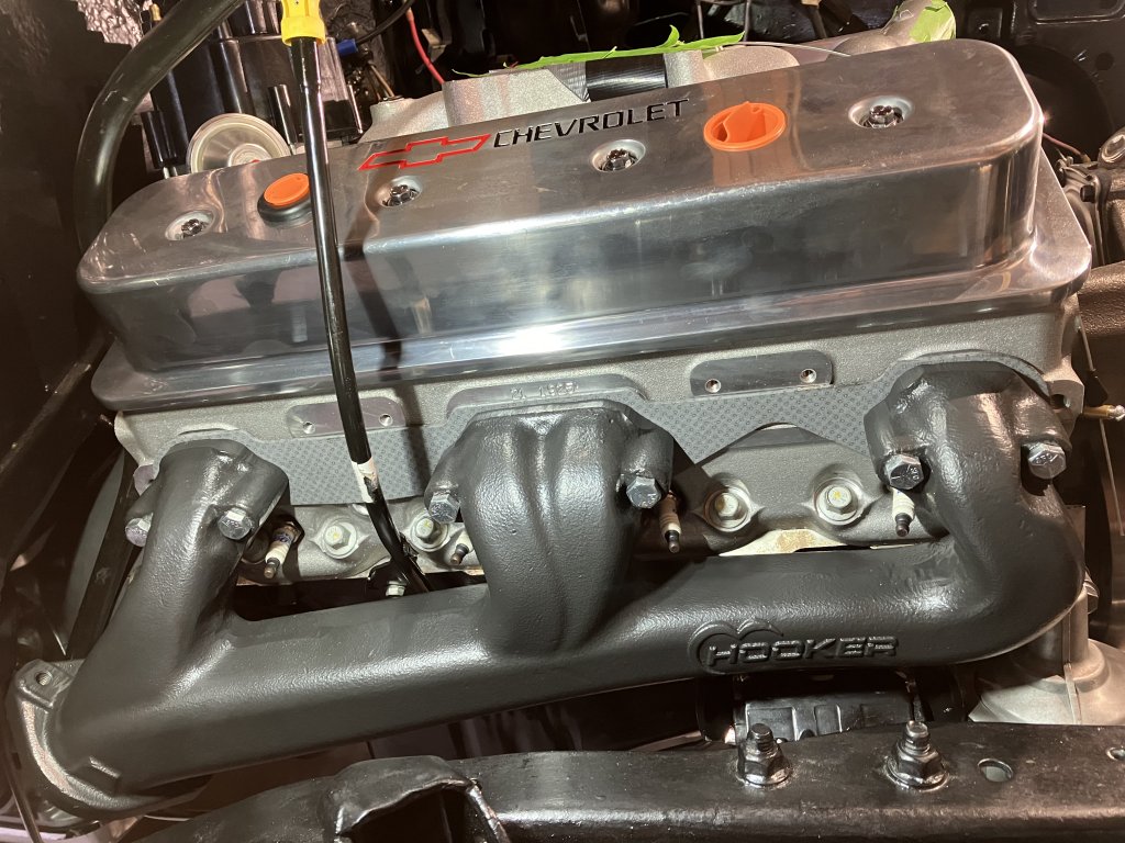

Thank y’all for the input. I may very well try to find one in a junkyard since I’ve exhausted all other resources. However, I did find aftermarket heat shields that attach to the mufflers as another possible option. Let me ask you another question, since I am considering installing true straight dual exhaust from the (latest technology) Hooker cast iron manifolds which is advertised as being less restrictive/higher flow than traditional cast iron manifolds (see pic) in an attempt to preserve as much horsepower as possible that I paid for in a new higher performance GM crate SP350 (385HP/405TQ). How much performance would I loose if I only run single exhaust through one muffler and one tailpipe (or split into two tailpipes?) vs straight duals with two mufflers. If the performance (HP/gas mileage, etc) is negligible then perhaps I shouldn’t even consider dual exhaust. It’s not a race car! My goal with the exhaust was for better manifold to cyl head sealing with thick flanges, longer lasting, more durable, less maintenance, more quiet, good gas mileage but also without sacrificing too much power. Basically, I wanted to find some middle ground between poor flowing cast iron manifolds and headers. I’m probably over thinking all of this! Would appreciate your input on this!

The heat shields for the muffler are not needed as much as the Cat. The Cat gets very hot and much hotter than the mufflers. Leave the Cat heat shield alone. You can run 3" singles and be close to dual 2 1/2 up to 300 hp. Never knew Hooker made exhaust manifolds. They should be good!

A catalytic converter is not required thus my reasoning to remove that heat shield. What do you mean by “up to 300 HP”? My engine is a 385HP SBC350. Is a single 2-1/2” or 3” exhaust not enough flow or do I really need dual exhaust to get enough flow?

A single 3” will be just fine with your engine. Much less likely to have any drone sounds as well. Use a good flowing y or merge pipe.
