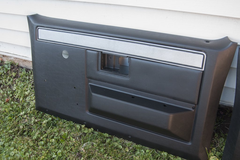

I been collecting parts to restore the interior on my '85 K30, but I have yet to find replacements for Silverado/Sierra Classic door panels. Most of the door panels you see delete the cloth insert. I found that Coverlay Mfg makes the correct panel design to fit the cloth inserts. The panels include cloth similar to the 89-91 style. It is glued it place, but I will be removing it. The arm rests and weather stripping is included and already attached. They come with options for power/non-power/combo. I got these through Rock Auto for about $285 for the pair.
The dark gray color I purchased is very close in color to the charcoal visors I got from USA1. The 4th picture shows the OEM style charcoal cloth insert. I will be adding the Silverado trim without pull straps.

That's a nice selection of colors available. Are they painted/dyed or molded in color?
Not sure if it's dye or paint. The back side is black plastic. FYI they must paint them to order. I had a hand written date on the back with the color code and a date 3 days after I ordered them.

Out of curiosity why did you go that route rather than the ones from USA 1 industries?
I wanted the cloth inserts and Silverado style trim, but not the map pockets or pull straps. It will look similar to what I did on my '79, except those were Scottsdale door panels.

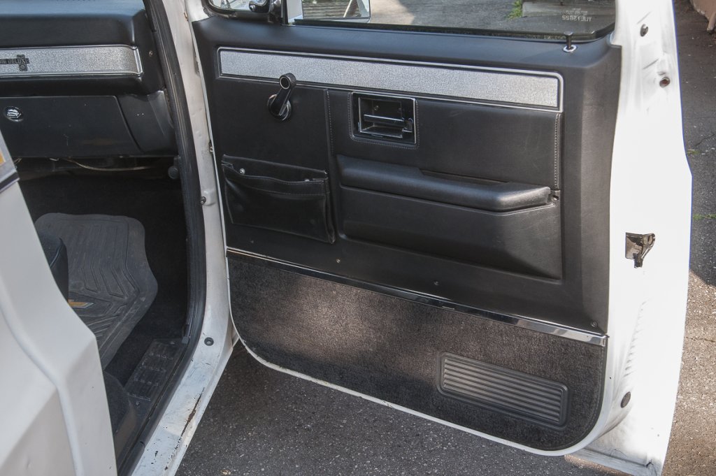

i found OEM vinyl insert on oem black panel is this rare? i think so! ;)

1984 and 1984
High Sierra K15 350. Sierra Classic C1500 305.
