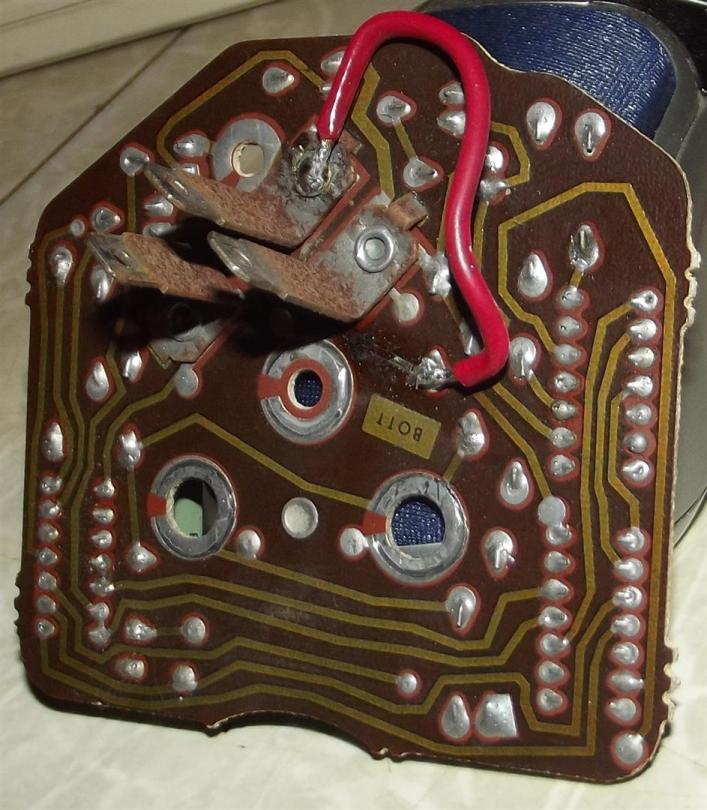

First thing I noticed upon inspection was a burnt circuit on the circuit board. Always look for the obvious first, sometimes it can be something simple. I trimmed back the burnt circuit to the positive (+) post, then soldered in a jumper wire from the positive post to where it was supposed to go...
attachment.php
Re-assembled and tested, and it did not fix it. Instead of reading 1500 RPMs with no response to throttle, it now read 2500 RPMs with no response to throttle. The next resistor in line from the (+) shows zero ohms of resistance so I'm partly wondering if it may be bad, too early to tell though. It could be a diode instead of a resistor, which I believe works like a check valve to prevent back feeding of voltage.

So now I have a couple schematics to do some testing. I have a computer power supply I modified to use as a 12v 18 amp power source for testing. It has built-in power protection and when I hooked it up to the (+) and (-) of the tach the circuit protection tripped in the PSU. Now I'm wondering if something is shorting out on the tach's circuit board.

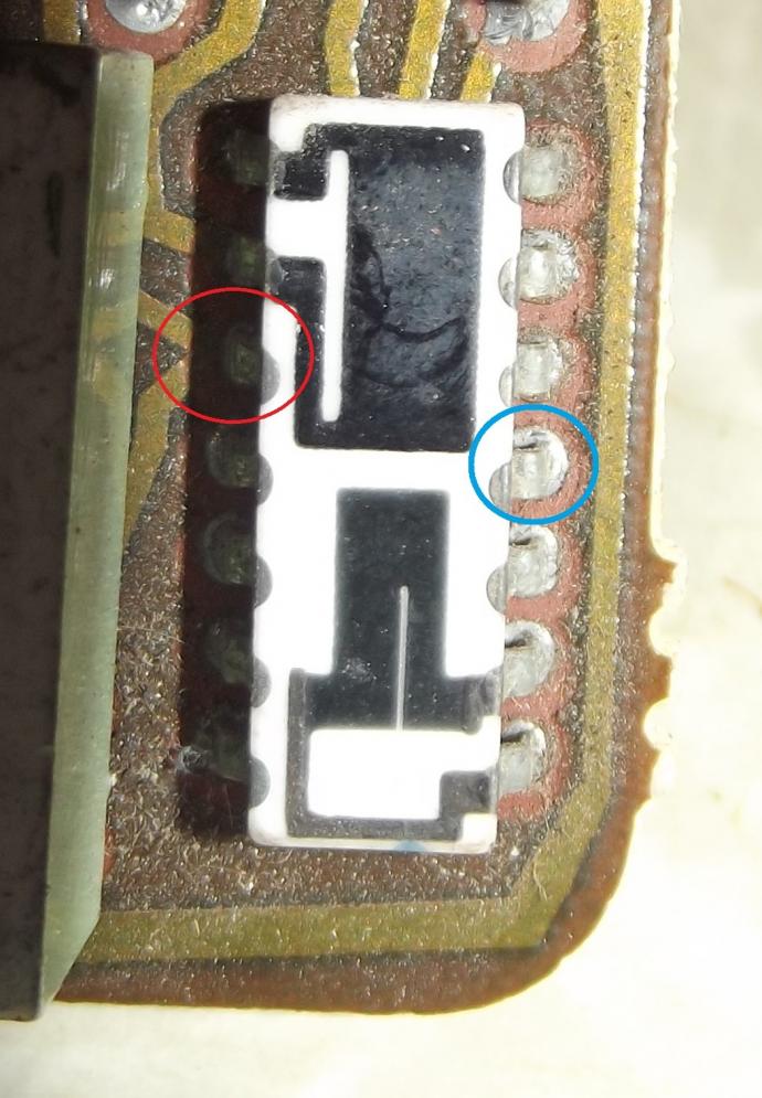

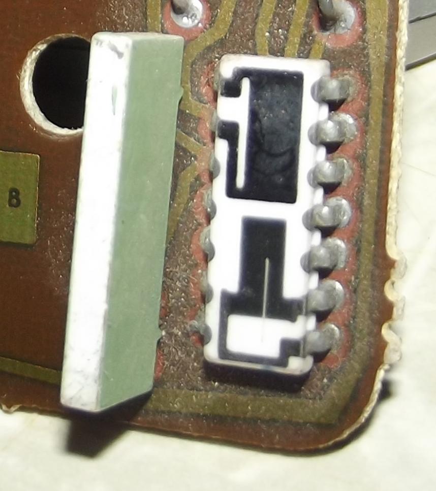

Near as I can tell, the write-up at the howtoalmanac.com website above outlining the resistor chip, this is the chip on my board...
attachment.php

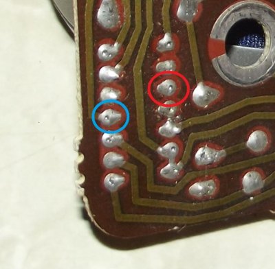

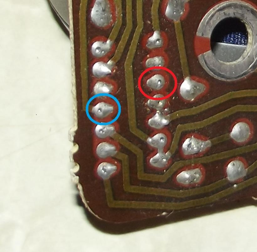

The pin described as having 2 leads going to it (#10) is circled in red below, and #4 circled in blue...
attachment.php
IF it turns out the potentiometer is required I am thinking these are the 2 pins to work with. The flipside of the chip looks like this, remember it is reversed and the circles are correct...
attachment.php

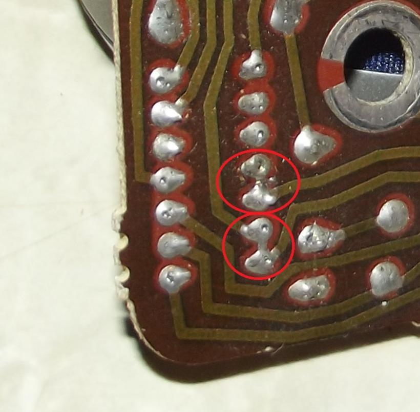

The thing that concerns me about this chip is the solder joints on two sets of pins seem to be touching, and I'm not sure if they are supposed to, circled in red below...
attachment.php
So now I have some testing to do. I will try to verify the LM181 is good, and get an ohm reading for pins 4 and 10 on the resistor chip, and post back the progress later...

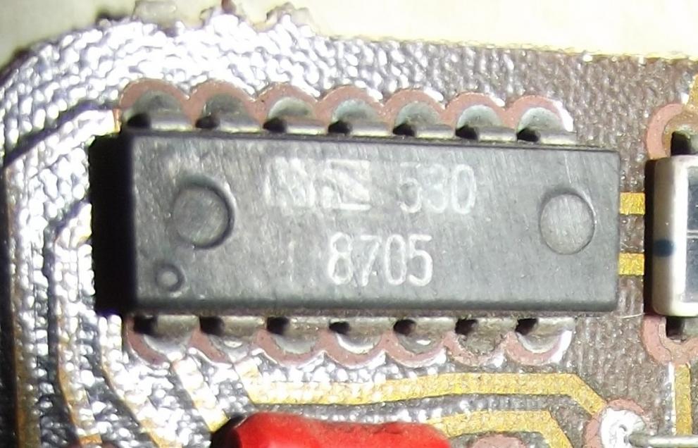

After a lot of reading and testing I am coming to the conclusion the air core meter driver chip (the black chip) is bad, since the tach is unresponsive to throttle. However is is discontinued and I can't find a cross reference for a replacement. The write up about the Camaro tach describes the chip as an LM1819 and the pics I've seen show the number LM1819 right on the chip, however mine does not say that. If someone could give me a hand finding out what chip I need or the replacement for it, would be great! Here's a closeup pic of it...
attachment.php
The insignia at the beginning I am guessing is "NS" for National Semiconductor but every search I've done for the numbers after that have lead nowhere. I would hate to order the LM1819 and it not be the same thing as what I need.

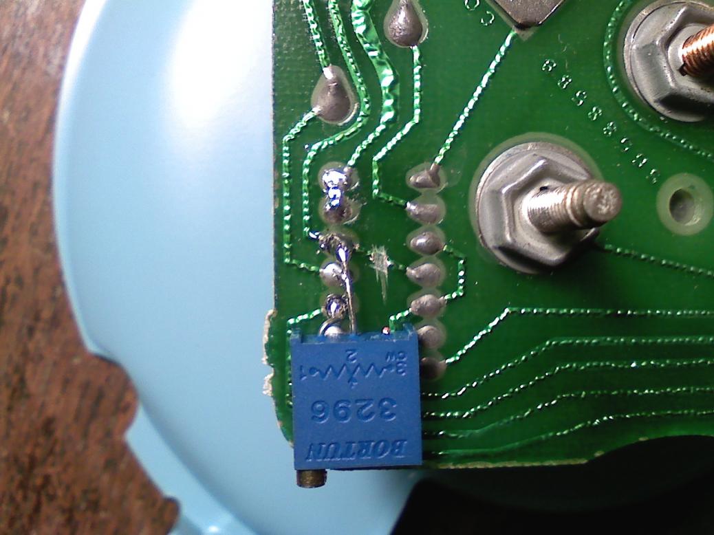

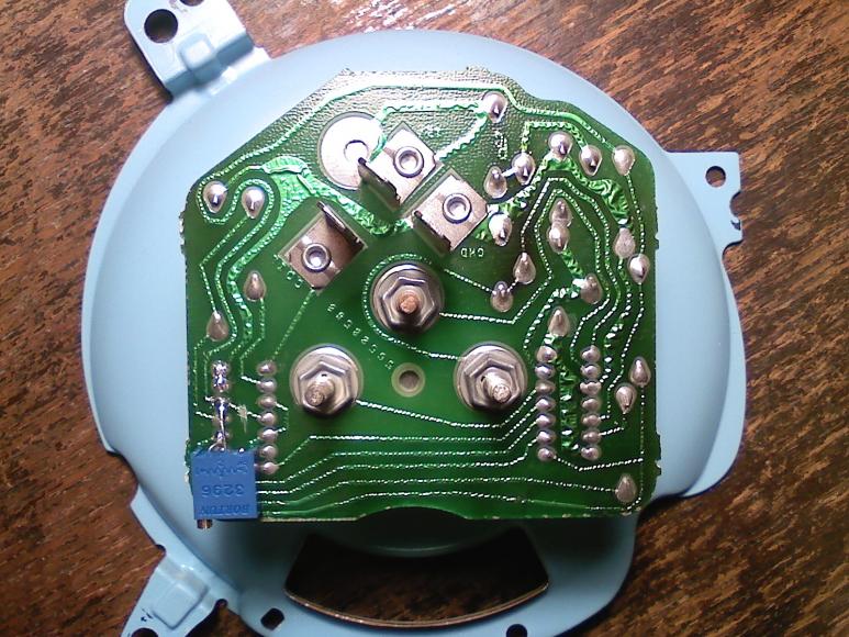

Hey I just joined so I could see your pictures because im trying to fix the one for my 78. Mine looks a little different than yours and mine does respond to throttle but it reads way too high. In your case I would buy a just buy a replacement circuit board from http://willcoxcorvette.com/product_info.php?cPath=1810&products_id=26788 , they make replacement circuit boards for corvettes and our trucks, when you order you have to put in the comment box to note that your ordering for a chevy truck. I have a thread about some different tachs ive found on another site too http://67-72chevytrucks.com/vboard/showthread.php?t=503733
I got ahold of Kevin that made the "How To Almanac" after I had ordered some potentiometers : http://www.ebay.com/itm/220870376302?ssPageName=STRK:MEWNX:IT&_trksid=p3984.m1439.l2649 and he said these were fine.
I think im going to send him another email so he can verify the correct trace to cut and solder to as id like to be sure before I mess something up.

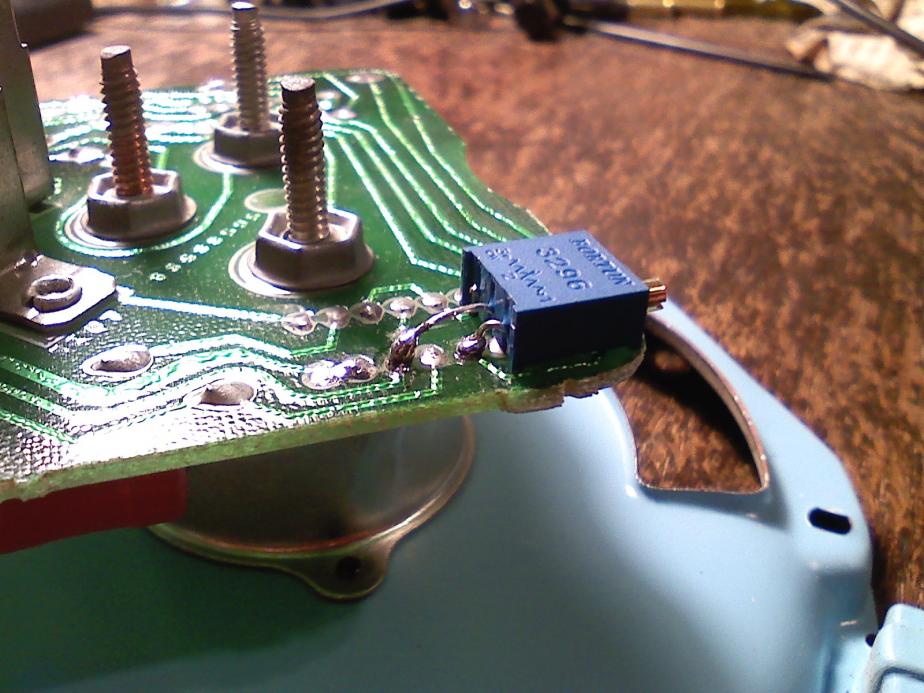

With Kevin's help I got my tach fixed and now its working as it should. I sent him pictures of everything and he said he was going to add it to the How To Almanac.

No problem Curt! Here's that link again for the replacement circuit board: http://willcoxcorvette.com/product_info.php?cPath=1810&products_id=26788 It didn't work the first time i posted it, they are $58 and when you order you have to put in the comment box to note that your ordering for a chevy truck. I don't know why GM changed the tach around on our body style trucks.

They probably only make them for the stock 4 or 5K tachs, then you could fine tune it with the POT

the number on that chip is the GM special part number that they had the manufacturer put on the LM181's for them
-Kevin
(howtoalmanac)
let me look through the pictures you have here and I might be able to get you an answer as to why your tach doesn't work.

ok, here's why your board is different from tony's and mine. your board has traces on the top and bottom. that's why it seems like nothing connects on the bottom.
it looks like the two sets of pins that are solder bridged are supposed to be that way.
can you put up some pictures of the top of the board so I can get an idea what's going on?
