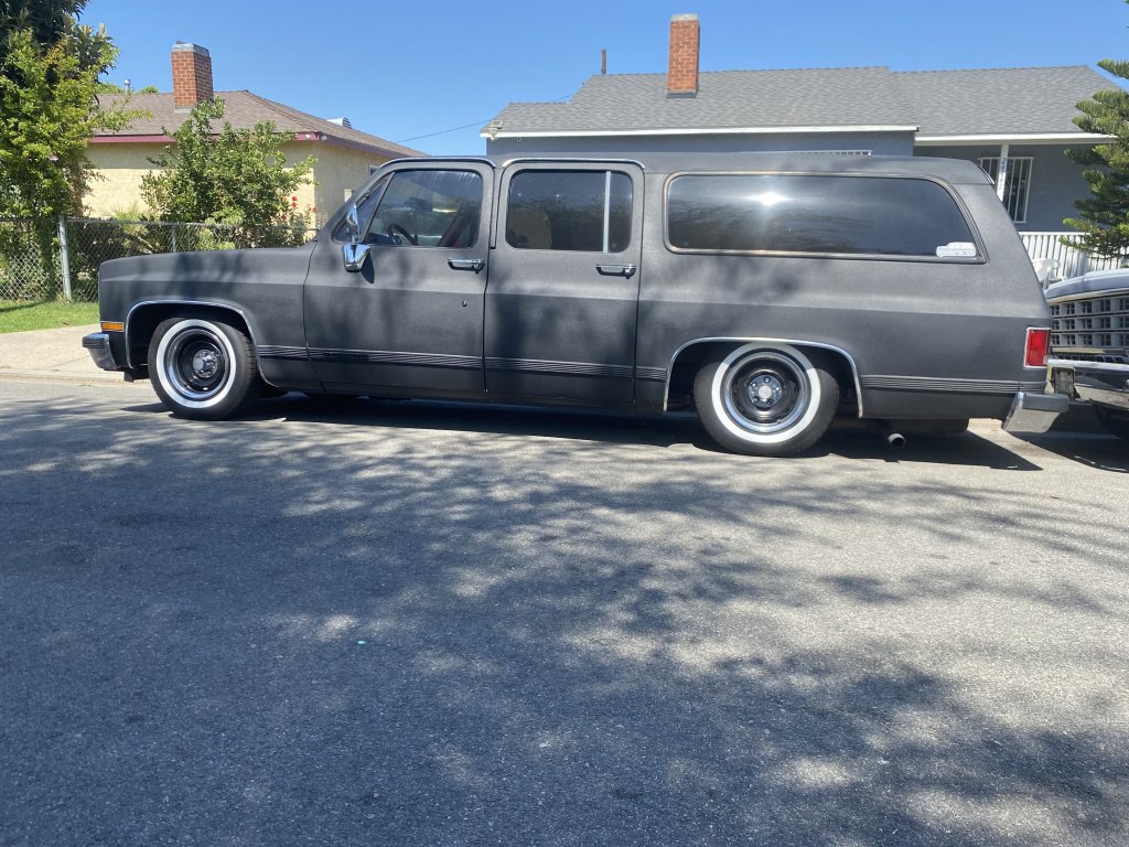

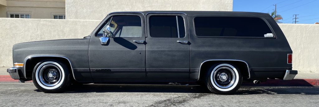

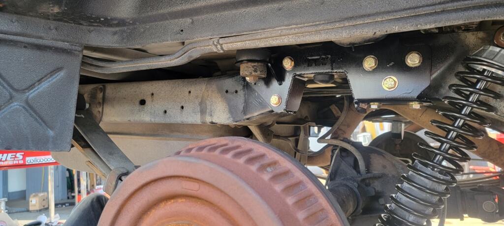

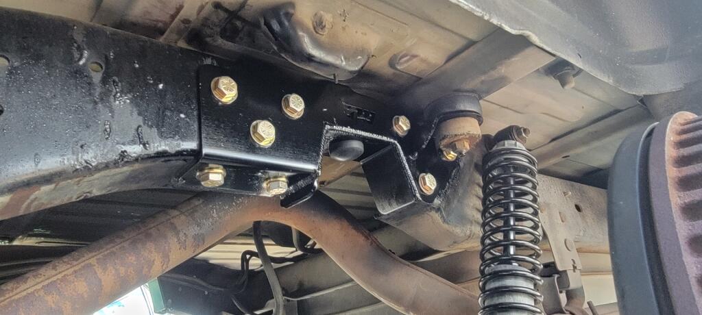

Ok I have a bit of a dilemma here I purchased a 5”/7” drop kit from Suspension Specialist out of Anaheim Ca. It came with 3” Springs and 2” Spindles along with a flip kit for the rear and the recommended shocks. Now here is where it gets interesting after installing the full kit the diff started hitting the frame so I decided to C-Notch it, it worked for a bit but as time went by (about a year) the back started to sag I’ve changed the shock multiple times (different size and brands) but it’s so low now that the have to be careful with any hump or even a drive way because it scapes the gas tank. Since I’ve C-Notched it bags are out of the question I just need to raise it about 3” for enough ground clearense. Besides reversing the flip kit and installing drop shackles what can I do to lift the back with out eliminating the rear flip? Thanks in advance.
