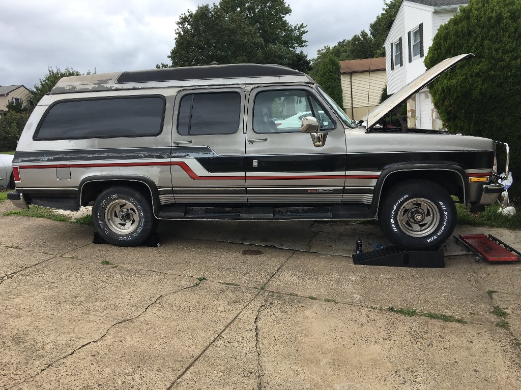

Hi there folks,
I'm in need of some guidance. The brakes on my Suburban are squealin pretty bad.
I will be doing the brakes soon and need to know where the recommended lifting points are. I have a 3 ton floor jack. My instinct is to go for the differential pumpkin but I've seen some people saying that the plug welds will pop.
So where should I jack up to get both front wheels up at the same time. Same question for the rear.
Once the truck is lifted, where should I place my jackstands? I thought I saw something about using the axle tube. I know on unibody cars, it's the pinchweld.

I'll add some photos of the underbody in case someone wants to just circle it or something.
Thanks everyone
