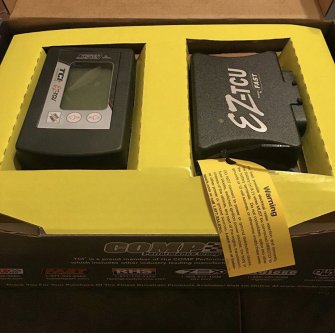

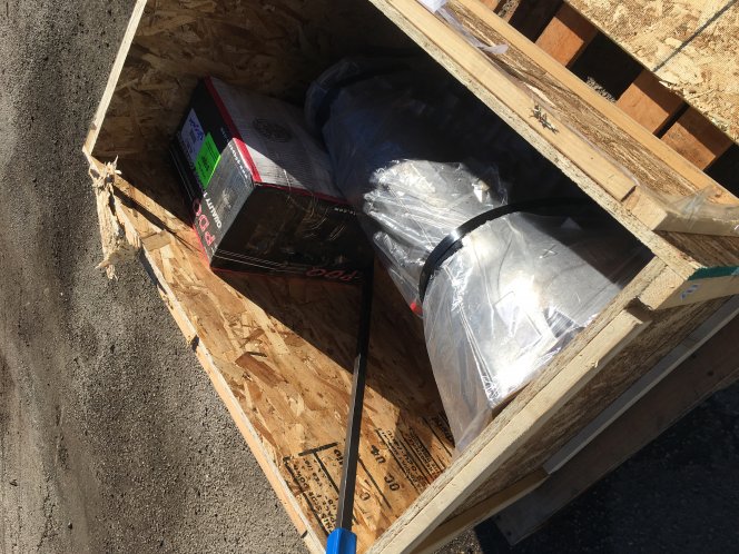

Finally got the trans this week, starting the process tomorrow. Ended up getting the bowtie overdrive, TCI computer, and keeping the 208. I'll try to keep the process up to date

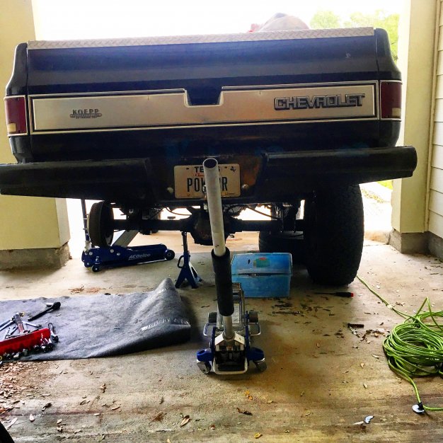

making some progress, got everything out of the truck and on the floor. Should be way easier than i thought to be honest. Here's a few pictures to show some reference. Just gotta pop off the adapter on the np208, change out the shaft, and connect the 2.

Ok, got everything in on working order. I have a 2 wheel drive 4l80e with an np208 transfer case. We added a new 32 spline shaft to the transfer case and a clocking ring (or spud connection) to mate the 2. With a 4" suspension lift, the driveshaft was the perfect length stock so no alterations there. TCI comp was replaced once, but finally started shifting second correctly.
