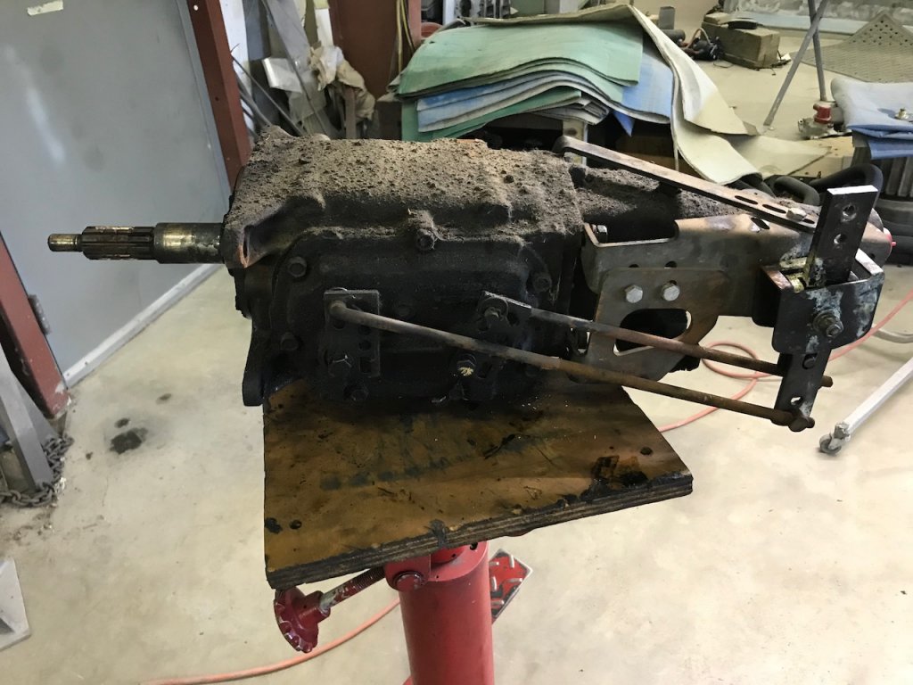

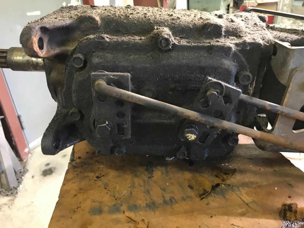

justhorns
Jun 1, 2022
10
9
Denver
Lee
250
Here you go, this is what it should look like.. This photo was from new clutch swap, and shows all
