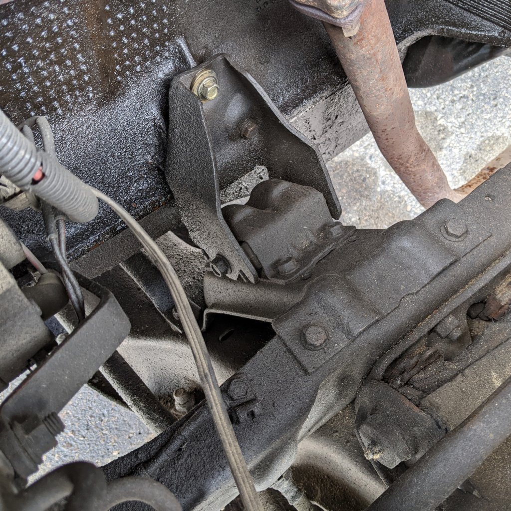

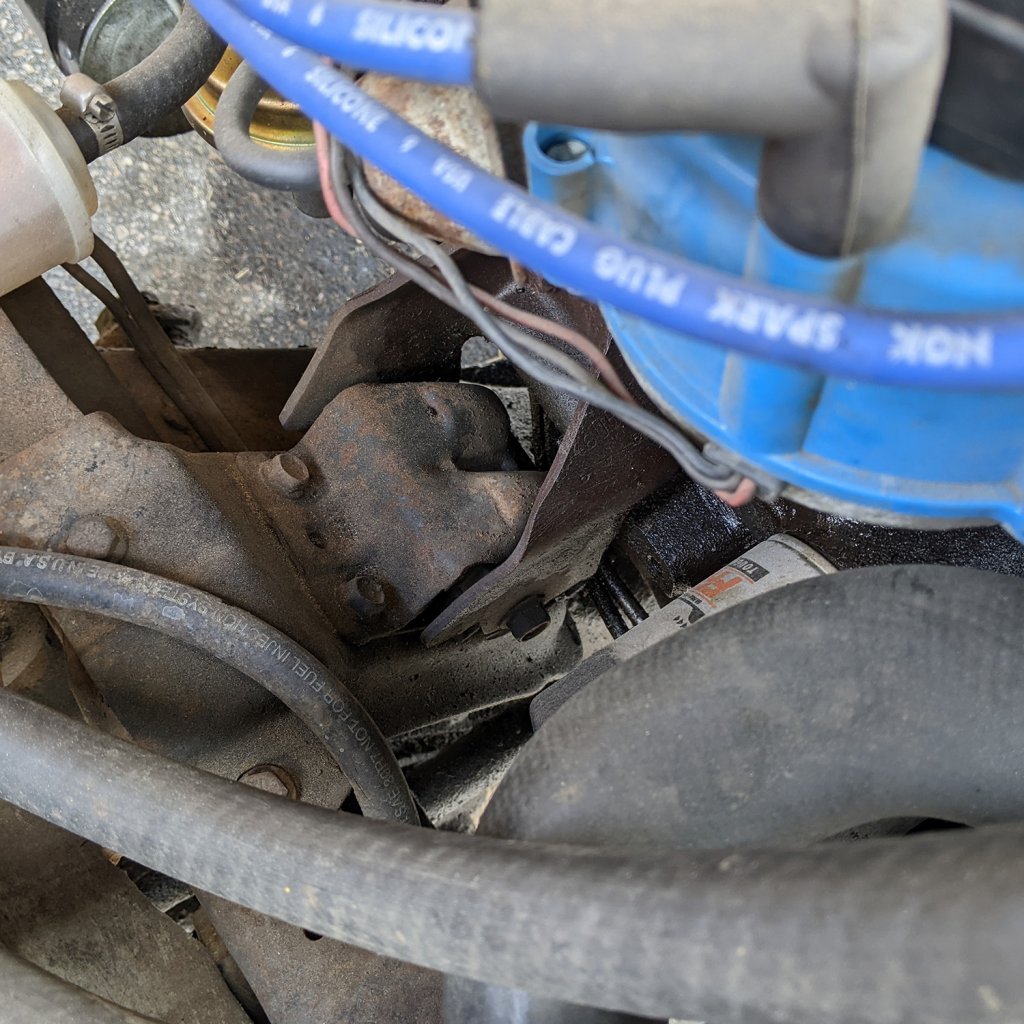

Here are a couple of pictures of both the driver and passenger side perches.
Oh, yeah you are good just like that. The 350 or 454 would have rounded cups that sit right down on those same clamshells, no need to get anything else. My only suggestion would be to replace the current ones with new ones for the motor you are going to install. They will look almost exactly like what is there currently, but the bracket on the motor side will be different.
This is what the actual 350 mounts look like. They will be 2292 part numbers. They are the same mount for both left/right. They are directional(at least the BBC ones are), and if you put them on the wrong way the bracket won't sit down far enough for the bolt hole to line up.
This is what the brackets on the 350 will look like.
They are the same left/right, and are the same for SBC and BBC.

Thanks for your replies. I have read conflicting info, some say the passenger side perch is different for the 292 but most of the posts I can find are talking about trucks from 67-72 I found a couple posts on the 73-80 trucks but they were swaping 250 I6 to 350's and I think the mounts for 292 are differnt than the 250. Doing the swap on my daily driver and hoping to have all the required parts on hand so I can get it done over a weekend.

I think the passenger side clamshell or perch on the engine side varies. It has provisions for a strut or rod that ties the tranny to the engine, if im not mistaken. Might just be a plate that sandwiches between the clamshell and block and may not be present on manual transmission equipped trucks.

@Empire402 i have a friend doing a 454 to 292 swap in an 83 K30, I checked with him and the crossmember and pass side motor mount frame bracket (I’m not talking about the mount) are different.

Can anyone help me out with a couple of photos of the frame brackets from a C30 that came with a 350? I would like to compare what I have with what would have come in 350 equipped one ton. Thanks.
Well... maybe your friend would be up to swap the brackets, since this guy is trying to go the other way. Seems like a simple swap of the 292 bracket to BBC/SBC one. I am a little confused on why they would be different frame brackets.
It may be that just the crossmember is different to accommodate the different position, I’ve never seen the parts side by side.
It’s going to be a while before my buddy’s parts are available, the motor is still in it and he hasn’t started on the truck yet.

I found a couple thread with them side by side and the bracket that bolts to the frame and crossmember is different between V-6, I-6, and V-8. The OP will likely need to just go to a junkyard and find a bracket from a V-8 truck. Looks like they are all the same for 305, 350, 400, and 454

The passenger side mount on a 292 is farther ahead (between the distributor and the fuel pump) where the 250 mount is behind the fuel pump in the same location as the V8's.
