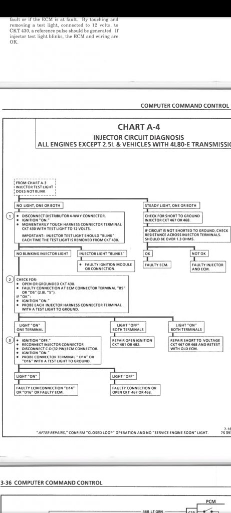

run through chart A3 and then A4 if the fuel pump is priming and you have spark. did you put a noid light on the injectors?

go through this. could be a bad ECM if that is where you land on this. they are available for about $150 I believe.
