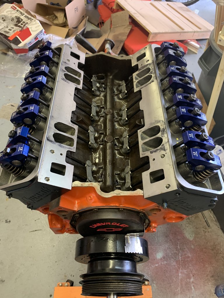

I have a 1986 crew cab short bed with the following modifications. It’s a 350 I put summit vortex heads on it with scorpion 1.5 roller rockers, retrofitted comp cams roller lifters, a crane roller cam .488 intake & .509 exhaust, edelbrock 2116 intake, edelbrock 1406 carb, a huggers GM5Xtm torque converter on a th400, with a 4:10 rear end. MSD coil, MSD box, MSD wires. My truck starts up and runs fine but if I punch it from a dead stop it won’t spin the tire, posi is my next add on. Once it’s rolling around 40mph it will run strong when I floor it. But it’s a dog below that. I was doing donuts in the snow the other day and it would just stall. Any suggestions?

Sounds like you need to tune the carb. Edelbrock carbs kind of suck to begin with, but can be ok if dialed in right. Did you make sure the floats were set right before you bolted it on? Have you set the idle mixture screws yet? WHat do you have your timing set at?

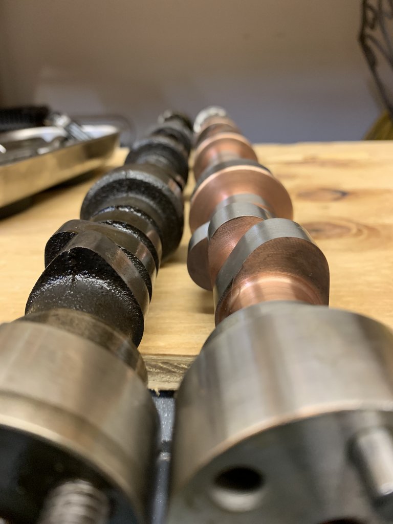

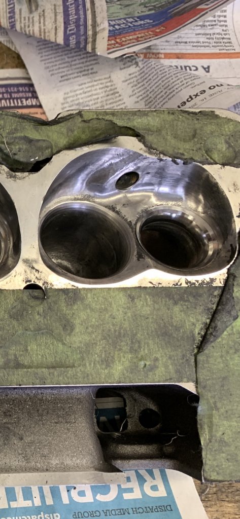

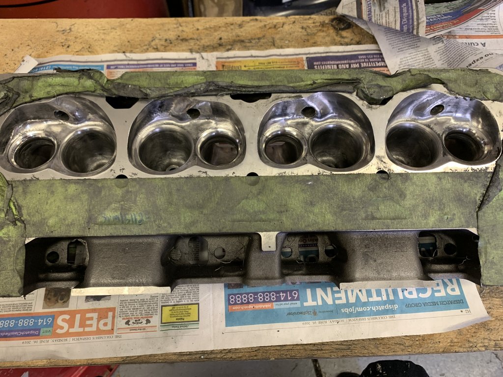

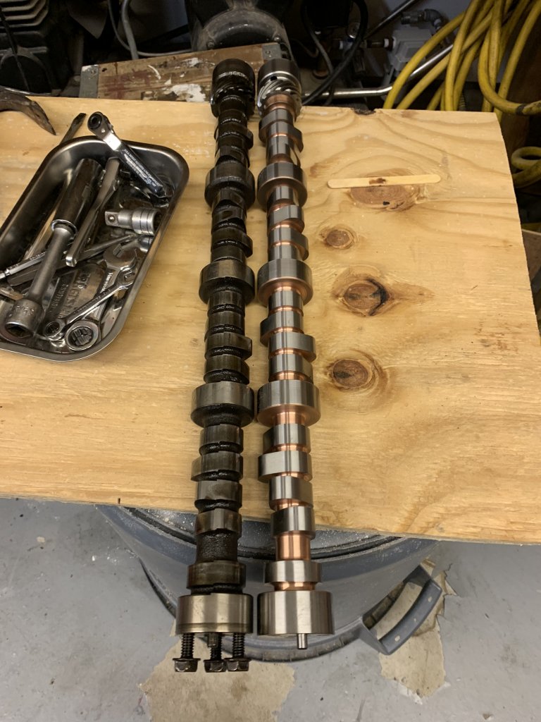

I’ll start by saying this was the first engine I ever rebuilt. But it fires right up and idles. My timing might be a bit off because sometimes it will stiffer when I floor it but not every time. I didn’t mess with the floats but I’ve probably put 2500 miles on the truck since rebuilding everything. It just doesn’t give the performance I was expecting. It doesn’t feel much different then before picture of old cam va new.
