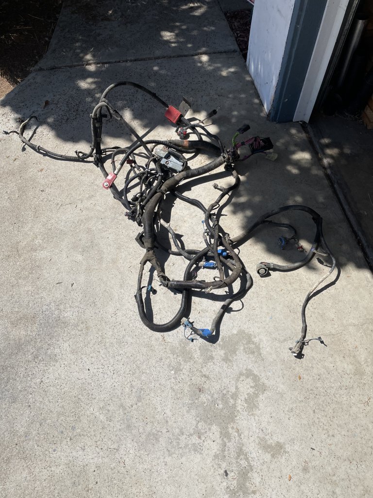

Scored an 04 Sierra 2wd with 120k. Yanked the motor and trans and sent the body off to the scrapper

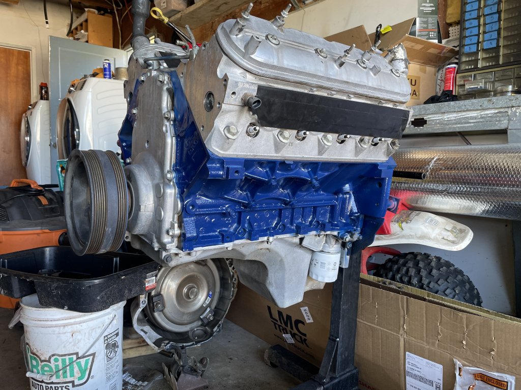

Cleaned up and painted the engine and trans. Still deciding on painting the valve covers to match or not.

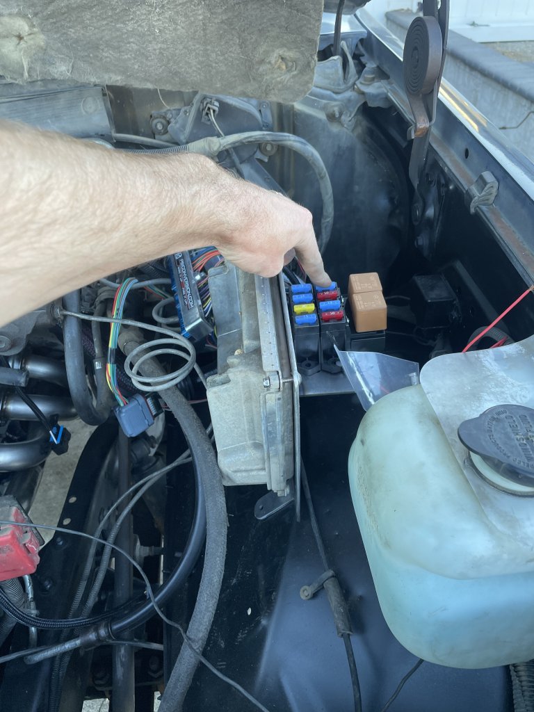

Got pretty lucky and only had two exhaust bolts snap in half. Also took a look at the wiring and decided I will for sure go with a stand alone harness

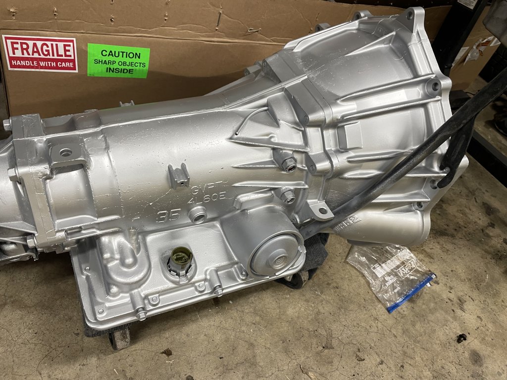

Engine bay cleaned up mostly and painted, beyond over cleaning an old diesel truck from 1985, on the plus side zero rust!
Took a stab at tearing into the 4l60e to swap out the output shaft. No guarantees that it works but turning the input shaft makes the output shaft turn when it is in drive!
