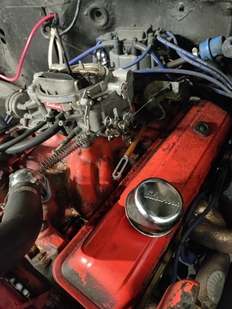

I replaced the modulator and checked on the kickdown cable it looks like when the last owner did the engine/ trans swap they ran a new kickdown cable and it is too long and not the right one. Anyway I left it disconnected took it for a test run with the new fluid/filter and modulator. Then I took it for a mile test drive everything seems to be shifting good all the way up and down. I still plan on getting what I need for the cable to be reattached, getting a shift kit.

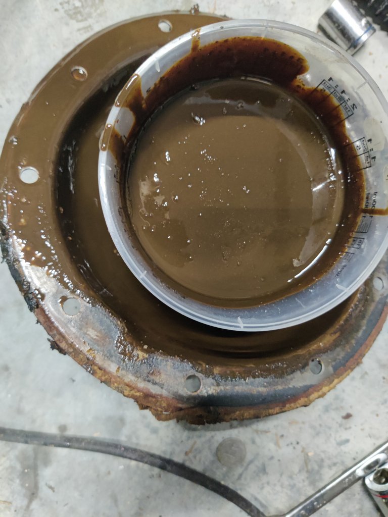

Well I reconnected the kick down cable. On my second adjustment I tried going in reverse and I noticed a whistling sound and It really didn't want to move very easily. So I checked out the rear diff and some nasty oil milk shake. Could there be a problem with diff breather on it? can they cause water to get in? Just wondering if I should replace the breather? Thank you everyone

Well I reconnected the kick down cable. On my second adjustment I tried going in reverse and I noticed a whistling sound and It really didn't want to move very easily. So I checked out the rear diff and some nasty oil milk shake. It looks like there is a diff breather on it can they cause water to get in? Just wondering if I should replace the breather? Thank you everyone
I'll bet the guy you bought it from used to tow a boat trailer with it. Backing the rear end down a boat launch into water is a quick way to get water in the rear end. Generally a breather won't let water in while driving, if anything they usually get clogged and that causes leaks/ weeping seals. Definitely good you changed the oil, breathers are cheap it wouldn't hurt to toss a new one on there. How did things look inside the rear? hopefully you caught that one just in time too...
But I really doubt that had anything to do with it slipping in reverse.

I'm just letting it sit to drain a little more while I go out to get new oil. I have to clean all of the brown oil out but all of the gears looked in tack no visible damage but I have not rotated the rear to check everything out yet. I was just a little worried about the whistle so I decided to check out the diff good thing I did too. The truck sat most of the summer I have a brake job to do on it because its pulling to the right maybe something is stuck.
I've owned it for 5 years with minimal maintenance decided it was time for some belts and while I had everything off I replaced the alt, thermostat and water pump. The coolant neck and power steering line were starting to leak so those got replaced as well. After I did all of that I was like time to drive and it was nope. The trans and diff I should have done after I got the truck since you never know what the last person did to it I wasn't thinking but its all hindsight now.
First time with Melted Beaver?
Mine smelt that way at least
Water, dirt seem to have found their way in but it isnt out of the reasonable for it to be water + wear and not heavy on the dirt but time and normal use otherwise.
My hose was broken up top and it was likely dirt and water collecting for years while ontop of it a dirty dusty bed.
if your use will involve water activities like a boat, high dust, mud ,etc GM issues a TSB about relocating the vent for the axles to make for better water and life spans. you should put a vent on yes and you would prob be wise with a new hose. The noise unfortunately may be a RIP noise if its worn enough
this is from a ford but see its more grey or shale colored, I would expect an older 84 probably under normal use would look worse than this but maybe not so much brown. but the real question for wear will be the teeth on the thing and you see mine, not close, but any excessive wear or pitting or grooves or oddly shaped teeth would indicate some wear. but you do have wheel bearings at the ends you cant inspect without pulling which you may want to and if you dont see anything there you should spin the driveshaft and check for play there. that would to me, i think, make sense to be the pinion bearing but im not so confident on that Im still learning axles lol.
