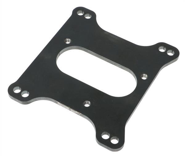

Should I try to get a tbi adapter or just roll with carb or is that just as big of a mess...? I know I’ll have to get a different fuel pump or regulator. Curious about trans and other potential issues I’ll run into. Not worried about fuel economy.
