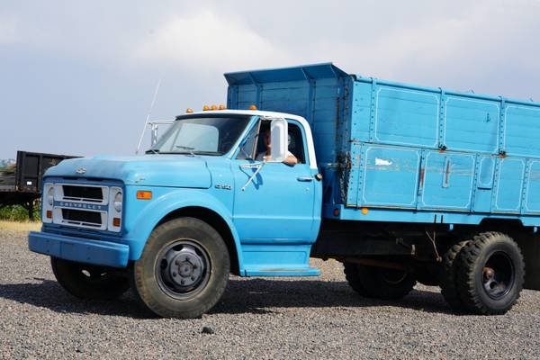

Well, maybe it's easier to just share a photo of it. I see 6 lugs in the front. Truck looks like its in nice shape from the pictures. Side dump "beet box" setup. Price is high though, seller is asking $16k.

If it's mechanically sound and road worthy, and all the hydraulics works, etc, 16k may be about right. Those big drum brakes were meant to stop the truck with or without a load.
