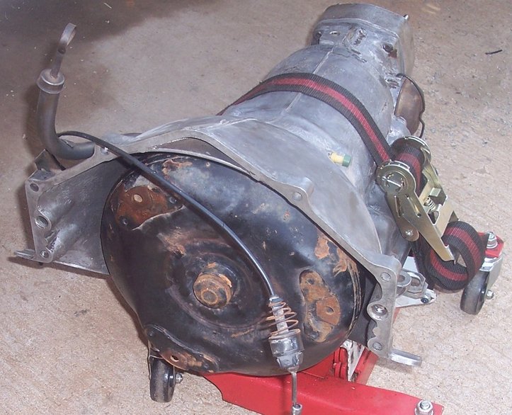

Soooo, now the transmission is explained. Yes, either Th350 or Th400 will work on the transmission. However, the Th400 being a bigger stronger converter, and more designed for bigger heavier vehicles, it's also going to be more mass to spin and not as responsive on the take off. If it were me, I'd run the Th350 converter with the Th350 transmission. There are a few different models though. The stronger of the Th350 converters is the one with the flat pads where you use a bolt and nut to mount to the flywheel, not the ones where the bolt lugs are welded to the converter. I'll look to see if I have a pic to show the difference and probably can even get the model #.

Here is a pic of the one I installed in my K1500 when I built the Th350 to replace the 700r4.
