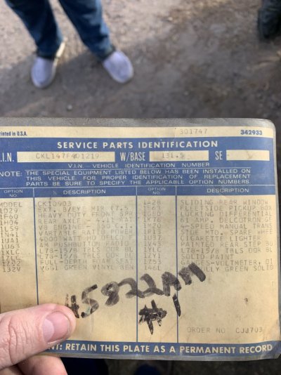

Is there a way, either by VIN or build sheet, to determine exactly what wheels my ‘77 K10 rolled off the line with?

The rims would only be on the build sheet if they were special ordered rims, like ralleys.
The stock wheel depends on what model it is.
What model is it?

It’s a Custom Deluxe. Not highly optioned. I’m assuming steel, but wasn’t sure.

A K10 with steep gears is always cool! So many came equipped with 3.08's.
Being that there's no RPO listed for an optional wheel, a basic white painted steel wheel would have been original. Standard was a 15x6 I think.

My wheel size was on the tag in the door jamb, 15x8. I knew they were steel wheels and hubcaps, but that sticker confirmed the size.
