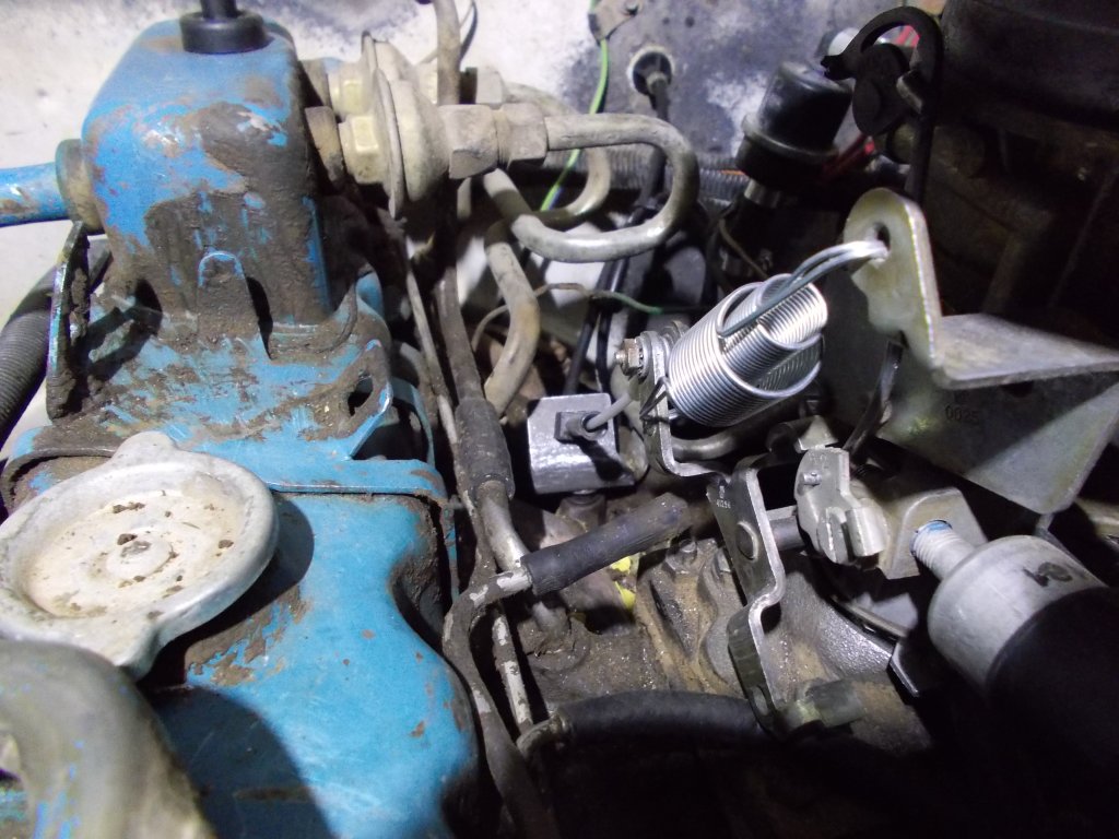

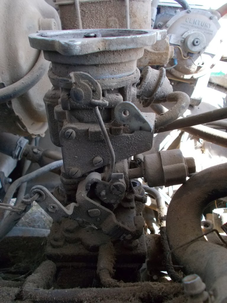

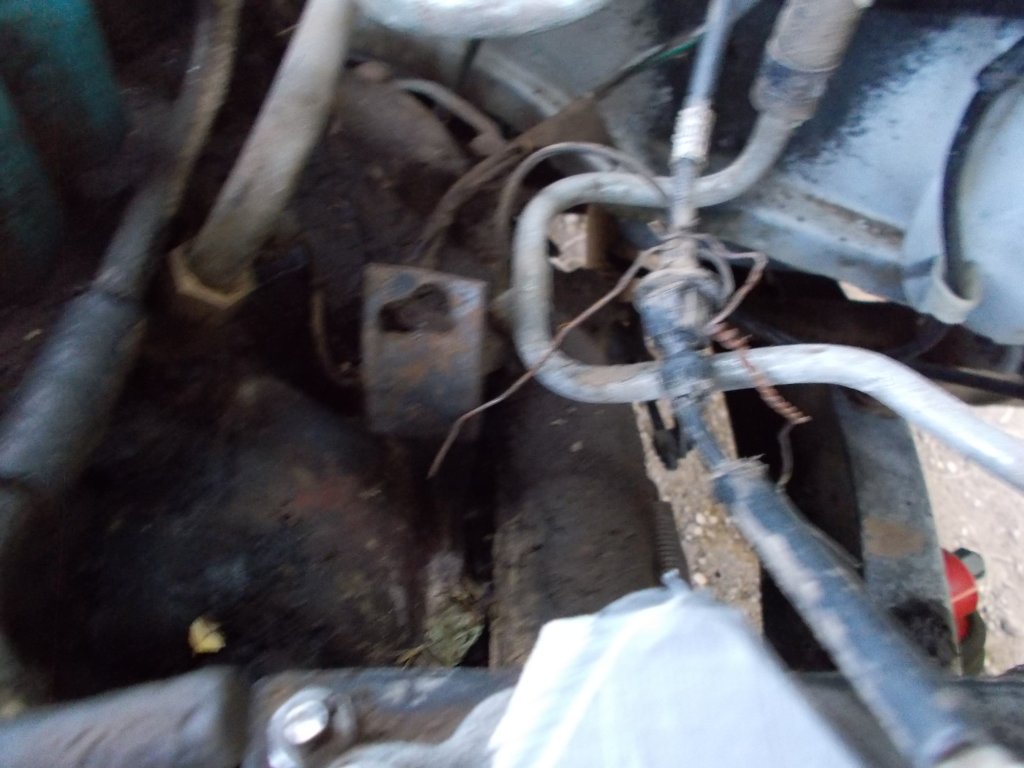

Sorry for the pic. I took the pic of the carb when I first got it so everything is dirty and covered in dust. The carb is off the truck as of now since I'm going to rebuild it and its in piece as of now. So the choke was facing the radiator. My goal as of now is just getting the truck running. I have no problem with the monojet as of now, maybe in the future a engine swap but as of now I just want it running. I also just went out and took a pic of the manifold as well as the why they has the throttle cable connect with a homemade bracket.

So after careful analyzing, i don’t know lol. Stumped me. I wish I had more experience in the realm and gm didn’t make it easier by having complete different cable setups for cars and trucks which also had different years way different too. When you say commercial do you mean like a cab and chassis or you meaning maybe medium duty at all? I the extra that is all there is quite baffling to me so im wondering if it’s not for something that doesn’t exist on a car. I know medium duty trucks and governors under carbs were a thing, but I guess im not sure what it is either so lol. Hmmm.
As far as making a throttle bracket yourself, do you have a new throttle cable? One with the plastic square push in thing that you depress the opposite side to pop em out the brackets? I think it’s square. Maybe it’s a different shape. I was going to say you could use a generic bracket for another engine and then use some stock to stand it off from a bolt or somewhere and bend and secure it to the incorrect engines bracket. If not for fatigue I would say go get some alumninum flat stock but that would be fatigue prone I think. If you get materials and a bracket to work with, you can just stand off the cable where it has to sit which you can determine that by pull throttle would WOT the plate and rest would be ideally open but slightly tensioned or just not loose I think.
I don’t recall if pedal side has adjustments or anything. Then a return spring just has to encourage it back.. which may require some spring testing. I couldn’t find much looking for i6 brackets :(

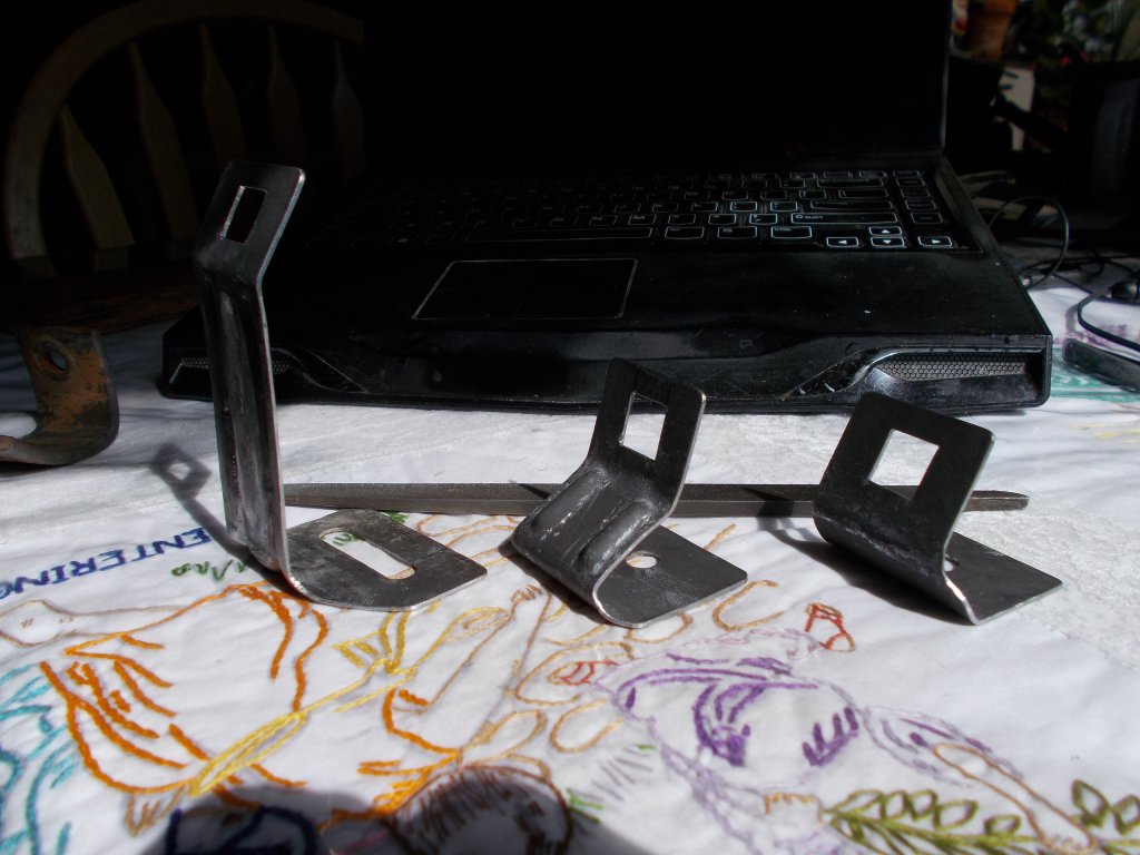

Yeah I have the newer style of throttle cable. I made a few brackets until I came up with one that worked. The third one is the one that ended up giving me the angle to get the throttle cable to go to full throttle. I did have to try out several different springs until I found out that worked.

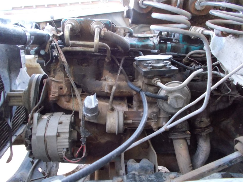

Yeah I did some research as well and I really couldn't find anything that looked like this setup. The monojet sits different than what I could find. So my guess is when they converted it to run off propane they downgraded the carb from a 2 barrel to the 1 barrel and by doing that they put a 2 barrel to 1 barrel adapter on it. Well that is my guess since the setup seem different than what I see on a 250 with a monojet carb.
from my research it seems car and truck 250 had different setups for those cables and stuff too kinda like how trucks had different qjet and the approach to the filter was different. not sure if monojet would be different car to truck. that might be an important thing to find out too if it is.
