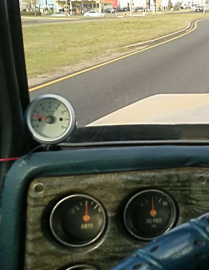

I bought that on ebay almost a year ago for ten bucks. It's 2 inch diameter and came with the cup.
It lights blue. Tach works great but sometimes I dont like the light.
Attached to the dash with one square inch of two-sided tape. It's so awesome until I install the other tach I posted...not real sure I should bother!
