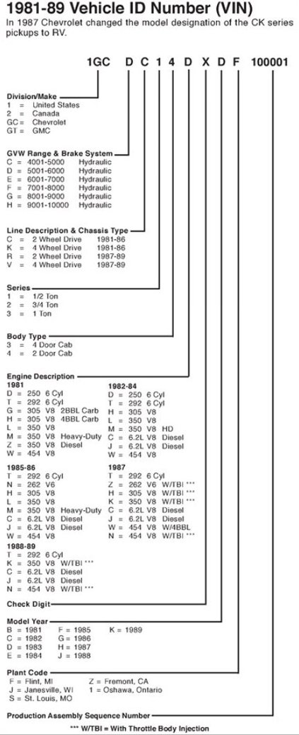

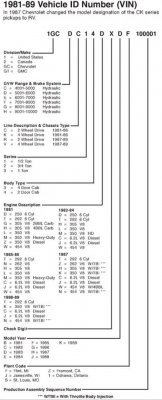

  8. 1987 GMC Jimmy
    1987 GMC Jimmy Full Access Member
    Age:
    21
    Posts:
    2,862
    Likes Received:
    343
    Joined:
    Jan 23, 2016
    Location:
    Wesson, MS & NOLA
    First Name:
    Jesse
    Truck Year:
    Truck Model:
    V1500 Jimmy
    Engine Size:
    Very true. The VIN will have to be cited on whether it was a chassis cab or not.

  10. 1987 GMC Jimmy
    Age:
    21
    Posts:
    2,862
    Likes Received:
    343
    Joined:
    Jan 23, 2016
    Location:
    Wesson, MS & NOLA
    First Name:
    Jesse
    Truck Year:
    Truck Model:
    V1500 Jimmy
    Engine Size:
    Crap. Forget all of that. I forgot that the newer VIN's don't tell you if it's a chassis cab. It did on the Action Lines and the squares up to '80, I think. Check for an RPO code ZW9. That's the only one I could find affiliated with chassis cab/pickup box delete.
