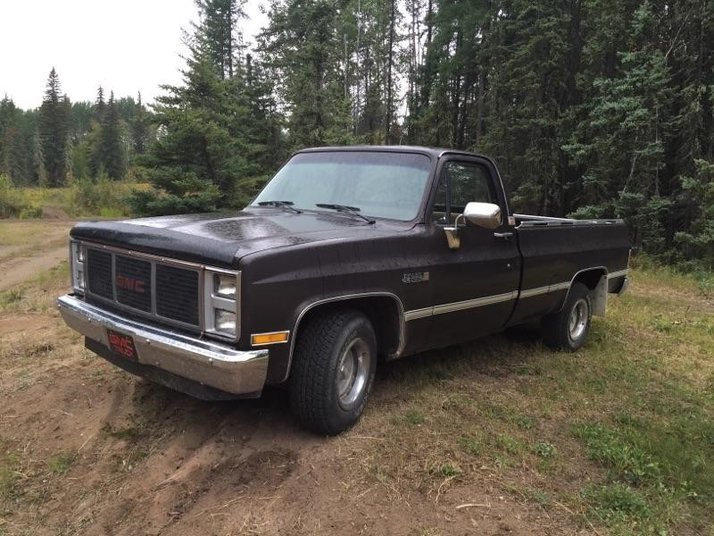

These were the only pics I saw of the truck before I had it shipped home. Looked clean and the price was right. Supposedly before my friend purchased it, it was farmer owned and this was his baby. I think it must've been stored in a garage or shop most days. :party36:

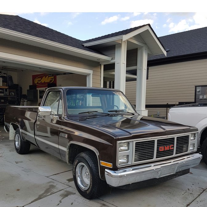

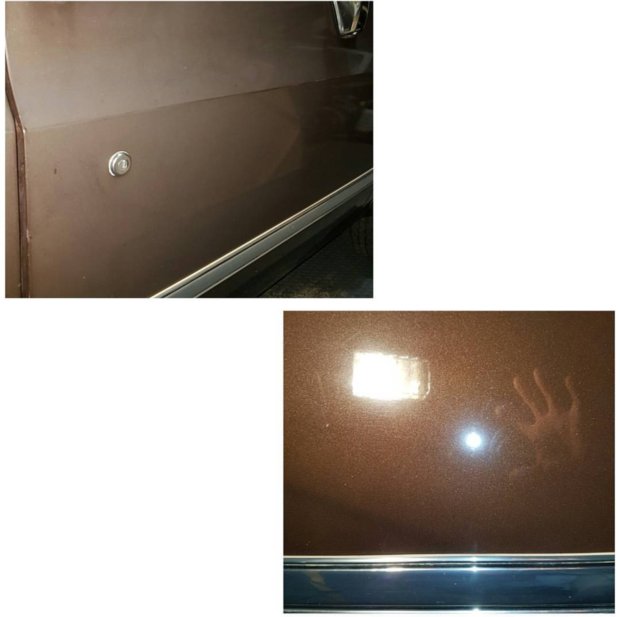

The paint was quite oxidized. I ended up using a clay bar on the whole truck, used a resin polish and machine, glazed and then a few coats of wax.
Here is a before and after on the paint. And the first time she rolled out of the garage. Looking good but...hindsight is 20/20. I really don't think I needed to use the machine. A hand polish would've probably worked fine. And I ended up going a bit deep in the paint in a few areas. It sort of went slightly egg textured in a few areas. Not a biggie, still looks incredible for factory paint and the wax fixed up any imperfections caused by me.

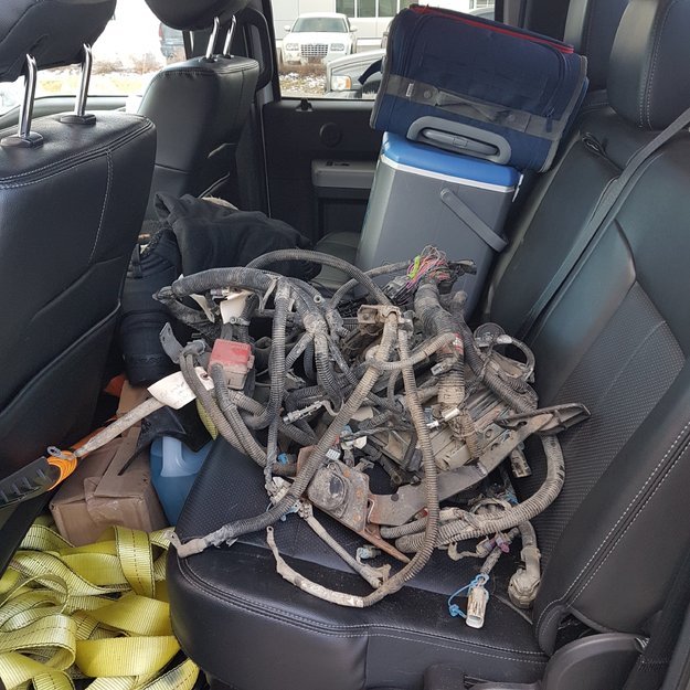

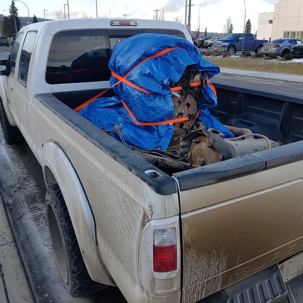

The old 6.0/4L80E and harness when I picked them up. Ended up selling the 6.0 and kept the trans.
The trans is really the only unknown piece of this puzzle. It has 240,000kms, no rebuild tag, dark oil and some sludge in the oil pan. We'll see if it will get me through this summer before a rebuild!

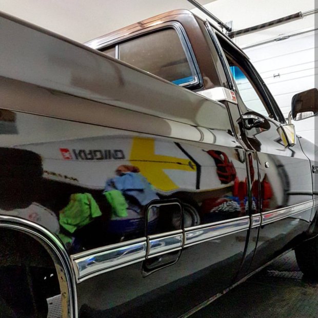

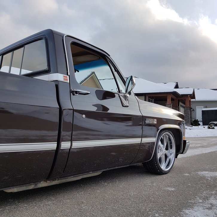

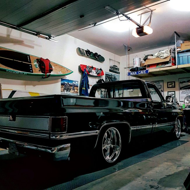

Next up was an elevation change. Went with the McGaughy's 6/8" drop. It comes with a notch kit for the rear but I haven't installed it. I can still lower the rear another inch from where it's at. I'll see where everything settles out when she's on the road. Bump stops are removed.
The wheels are 20" Eagle Alloy 225's. I fell hard for these ever since I saw them on a square. Ended up finding these pre owned but new in the box on a local classifieds. Score!

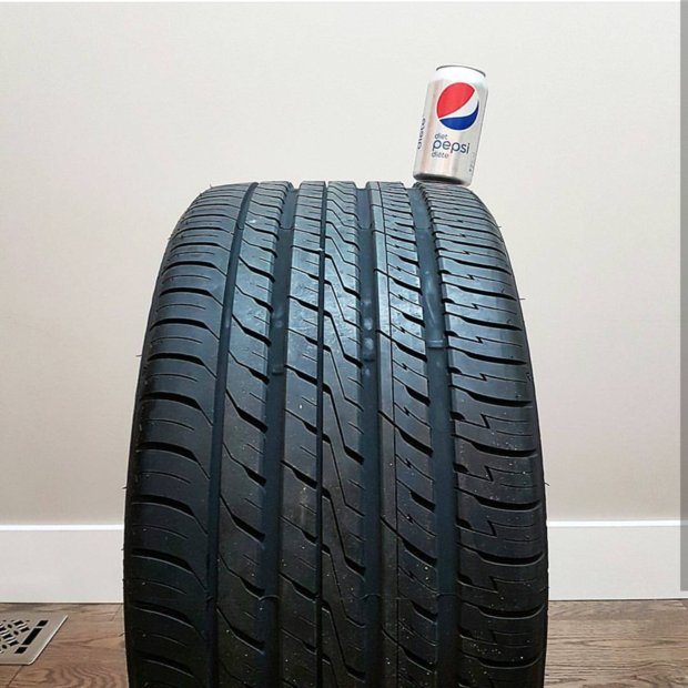

Rubber is 295 on the back.

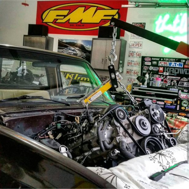

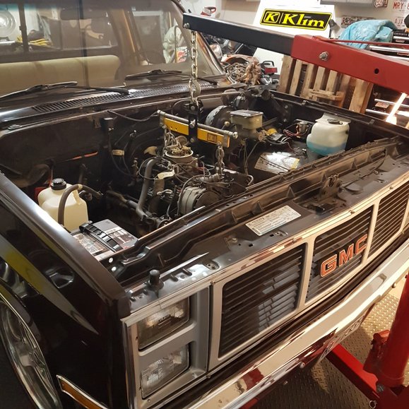

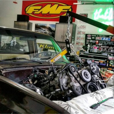

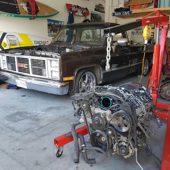

Vancouver Island
Jon
R15
The last time she will ever drive under factory power.
And out with the old and in with the new. Almost hurt to start pulling it apart. It ran sooo good.

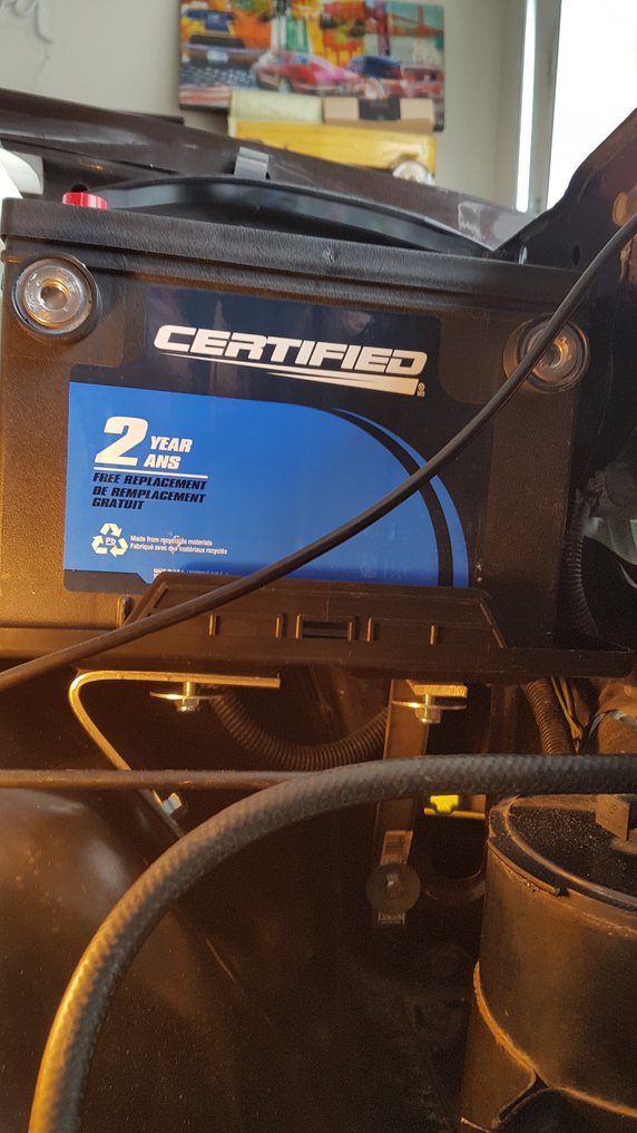

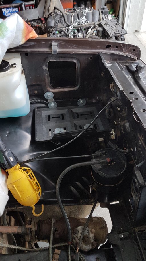

My intention is to run the cold air intake to the passenger side factory battery tray. The new battery for the LS3 will sit on the driver's side. For the life of me, I couldn't find a part number for the GM diesel trucks with dual batteries. So I built my own battery tray.
I just used a universal tray from the local parts store. For the brackets, I bent steel flat bar. Can't remember the thickness but it will never bend from the weight of the battery. It wouldn't even bend with me standing on it. Other than that, I also used pre made ready rod hooks and wing nuts/hold down tray for the battery. Unfortunately I don't have a pic of that right now. I painted all the steel up in gloss black.
