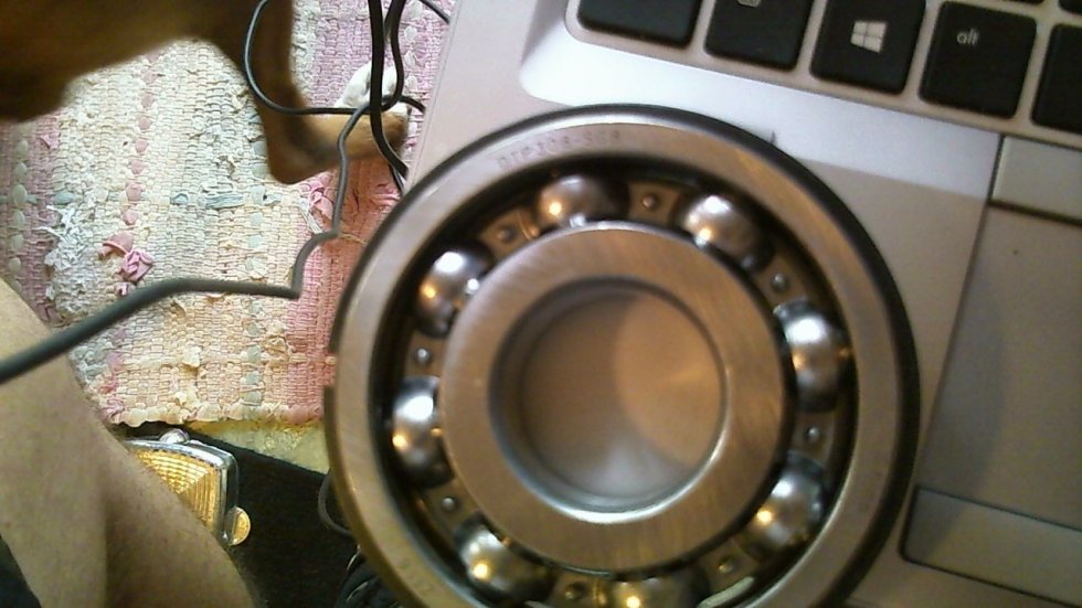

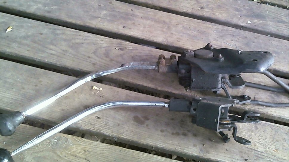

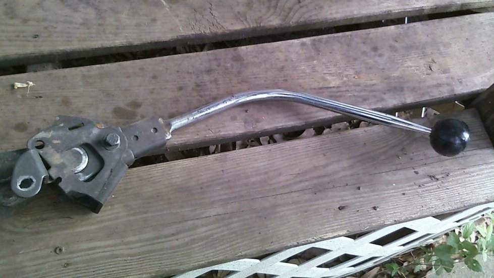

I actually found a shifter on car-parts.com off an 84 2 wheel drive and it fits!!! at least the rods fit. the plate looks differently.. here are a couple pics... and the kit I bought from DFW that was SUPPOSED to be TIMKEN are the same dang Chinese bearings!!!! hopefully they last a little longer =/ the first pic is the Chinese bearing, the second pic is my stock shifter, and the third is the 84 side by side with my 83... now that I look at it, the mounting plate looks different....I know that I put the main housing on the bottom on backwards when I was reassembling my shifter so ignore that part lol.
the bearing number is DTP308-SG8 .... its the equivalent of a 308 LOE

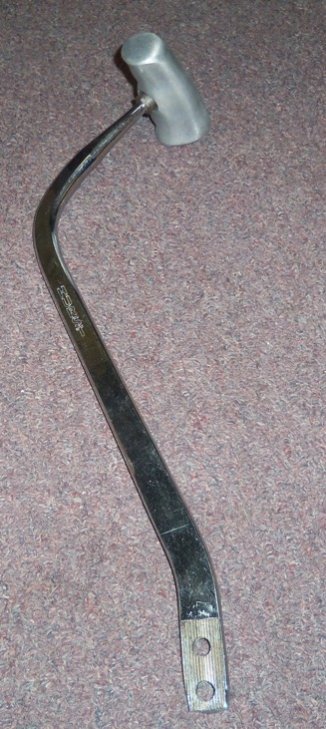

Thanks for the pics. The stick that came with mine is the round one. I'm going to be trying to retrofit my old Hurst stick from back in my racing days with the Muncie 21 and 22. Kinda bring some of the old memories into the the new. It may not work though. I just might hit the dash, but I'm going to try when the time comes.
