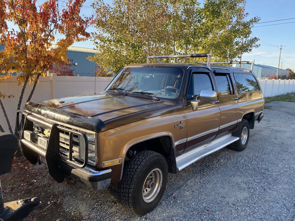

Totally makes sense. can’t thank you enough .
this Sub was used in the mountains of North Idaho and the lights were setup for driving in the woods were a lot animals are crossing. The setup was very broad with pretty deep light into the
road sides. Helps in seeing the creatures before they enter the road. Thanks again Woody
