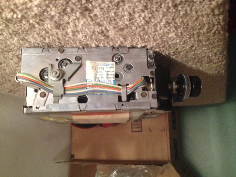

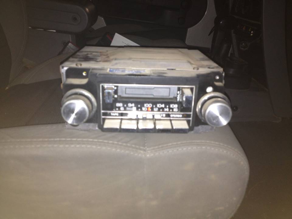

I found this cleaning out a friends grandfathers garage. Not new but looks great. May try to see if it works.

I haven't had a chance to try it out yet, and I don't have anything to put it in since both my squares have been cut for modern radios. Maybe someday I'll find an original truck that needs it.

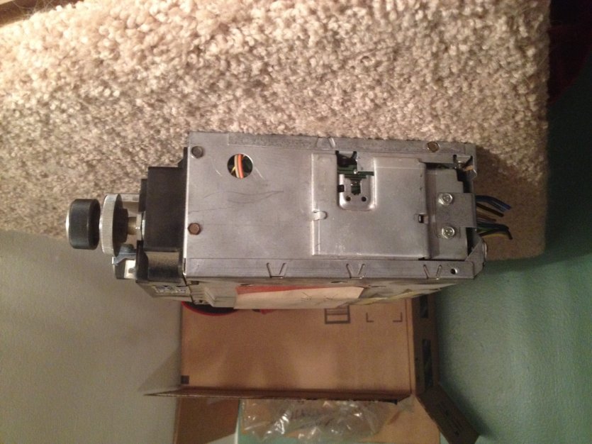

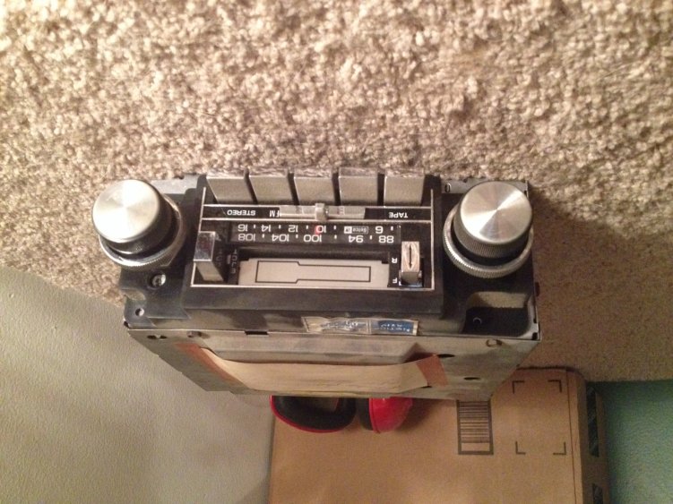

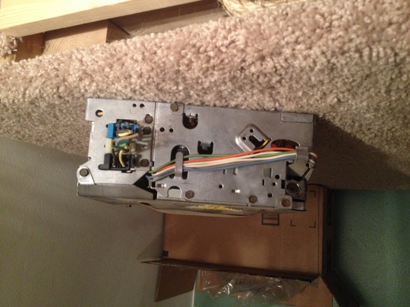

A few more pics
