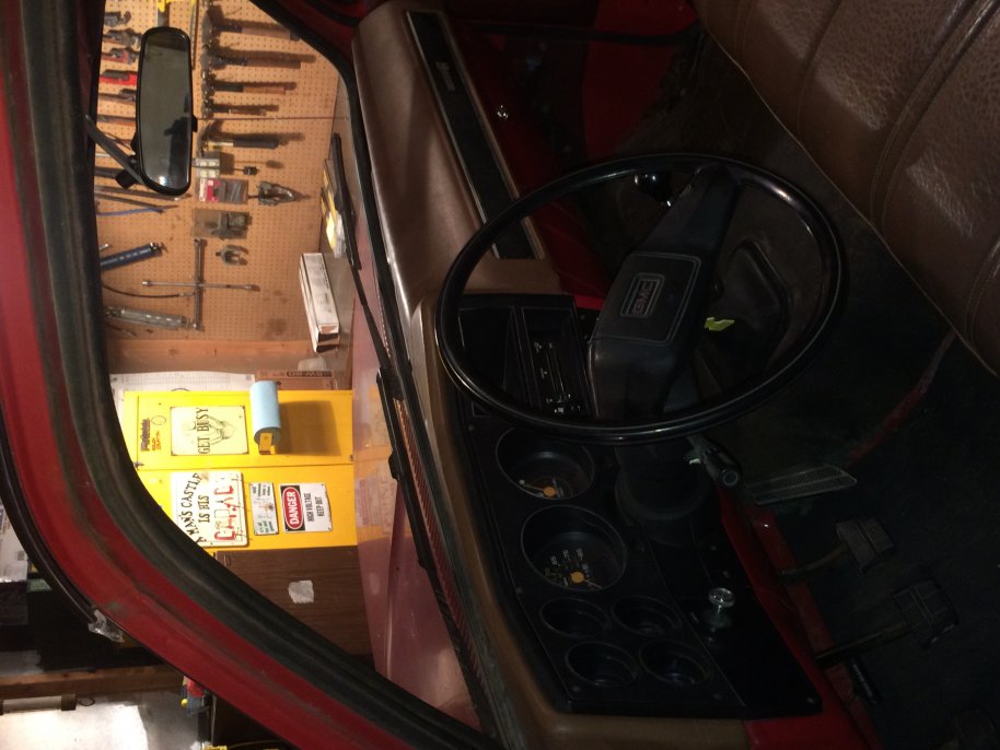

Has anyone installed an pre 80 dash and instrument bezel into a 81-87 ?
I have. It goes right in but the headlight switch may be in the wrong spot and the wiper switch was located by the headlight switch too. If I remember correctly I made a plate to mount those two compnents in the correct locations. I just put a 76 dash in my 87 but I don't have the correct bezel for it yet so i slid some weatherstrip into the gap to give it a finished look for now. The dash pad would cover the vin but I moved it to the door post for accessability.
Ya that looks cool! Nice trick with the weather stripping. Good to know Im gonna keep my eyes peeled for a pre 80' dash pad and bezel.

I am always suprised how much those bezels go for on ebay! At one poit I had a half dozen of them in a box. I figured they were a dime a dozen so I tossed em when I moved. Live and learn. Thats an 87 bezel in the pic I posted. When I put my other truck together I put all the interior pieces from a 78 into an 86 cab and thats when I needed to move the light switch and mount the wiper switch if memory serves.
