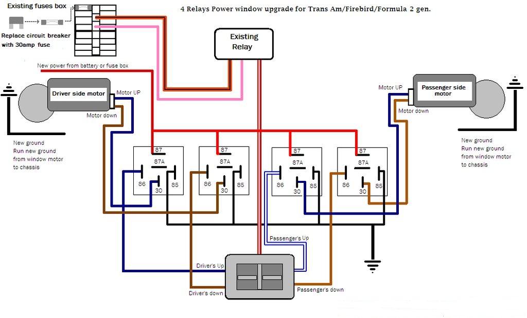

here's something to consider. DON'T use OEM wiring! Go with relays. The windows work faster and won't burn out motors.
24,569
5,931
Nice diagram. HotrodPC has a links posted somewhere in here for factory plugs/connectors.

AWESOME info BADAZ
I copied it to print off... definitely the way to go.
Thanks...
If I can't find any OEM style plugs for the motors, I'll make my own if I have to.
