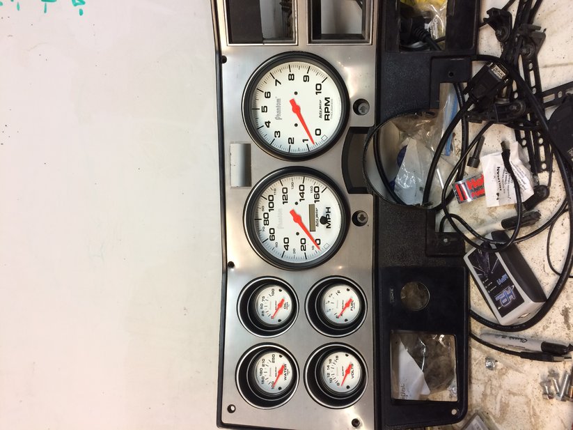

I have an 85 K10 and the gauges quit working. I would like to know if any of you put in Autometer gauges in your dash cluster. And if so what size gauges did you use. This is my first square body and first rebuild. Any help would be great

2 1/16" and 5" prepare to cut the backs of the gauge pods if you want them to fit

Everything is electric. Did an ls swap so I had the signal at the ready.
