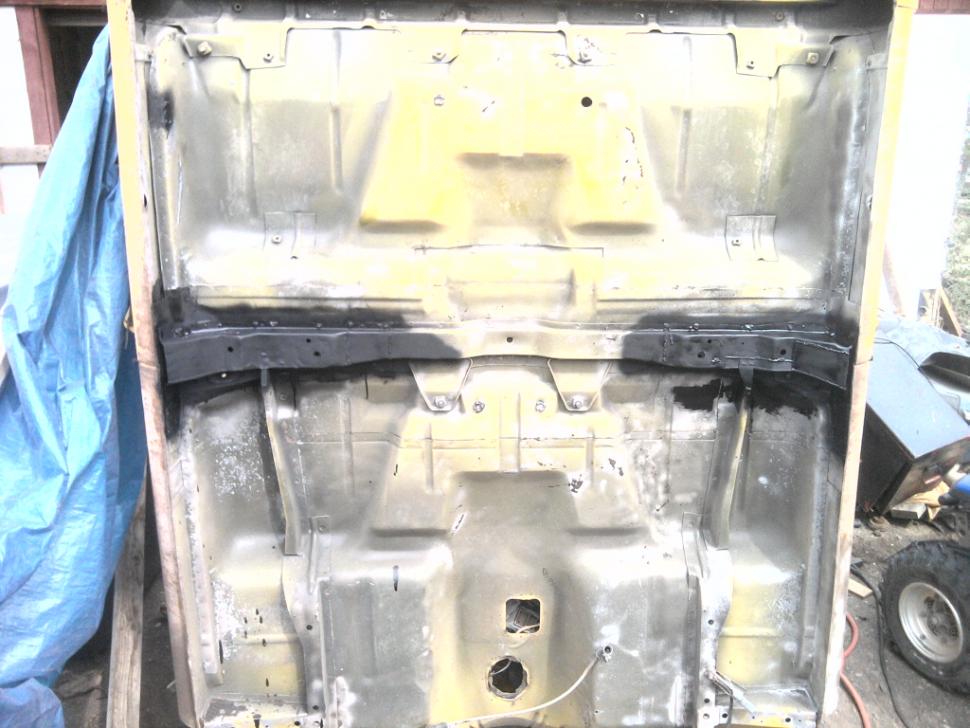

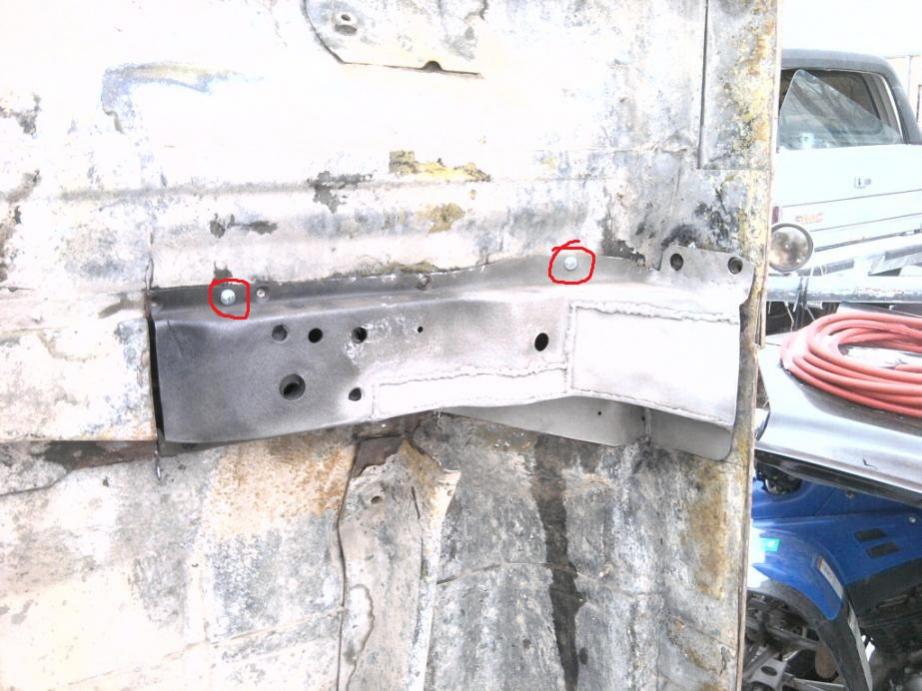

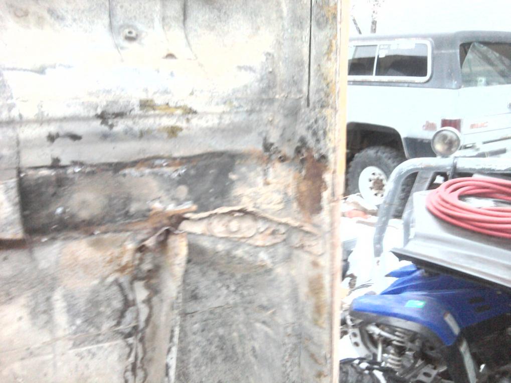

i took my crew cab cab off the frame and stood it on the firewall to fix my center cab mounts

LOL no.. I bought it, drove it home, started looking at it further, and the more I dug into it, the worse it looked..
Looks like 2 feet of snow has now post poned any thoughts of working on this right now..
Honestly, from the outside, this truck didn't look this bad.
It was a family friend who needed money, and at the time I had $700..
Buying a cab will cost more than the whole truck, at least all of the prices I've found do around here. Also, this is usually for a cab with no title, and then I have VIN# issues, and I am the guy who the cops throw on the ground, and zip tie hands and feet if I spit out chewing gum and miss a trash can by inches in a no littering zone, so while a bunch of you all can get awya with it, the Gestapo will show up, knock my door over, fill my house with tear gas, probably shoot my wife and kids, and set fire to everything else I own if I were to ever consider tampering with a VIN plate on this truck.
So I see the recomendation is to put the replacement floor pans in first before cutting the supports? I would have thought it would be tweeked already, since if you look at the two mounts, they are actually broken in the middle!
Scared the crap out of me as I began taking this truck apart, I took the carpet up, and found some sheet metal held in with sheet metal screws, so I pulled them off to take a better look, and there I saw, this cab was basically held on with the fedners, and the rear mounts!!!
