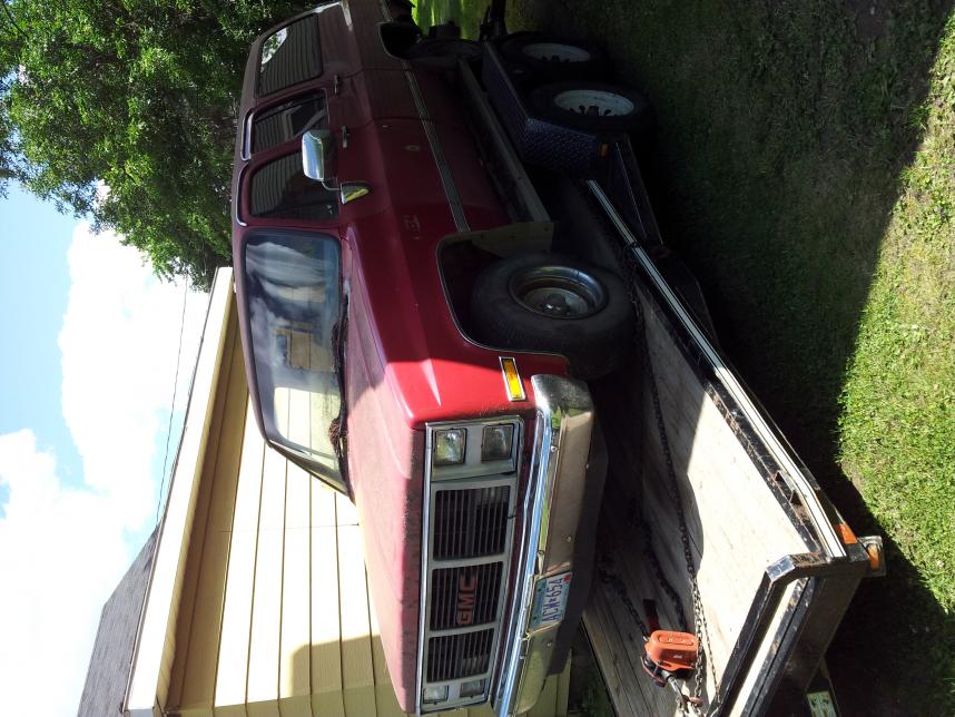

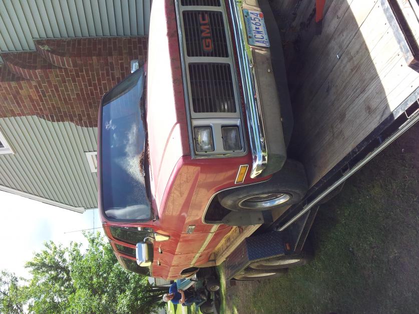

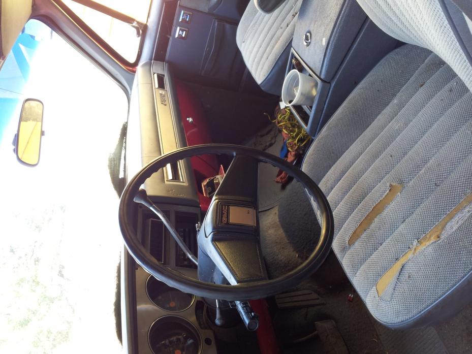

Might scrap it, she's rough! 88 1/2 ton 2wd. 152k, some pwr accs, pretty much bought it for doors and wiring but may get it runnin. Fuel pump wire is shorted to ground, mice have taken over! O well at the very least I can part and scrap it, only paid $300, can't go wrong there! I do miss my 91 waldoch burb tho...rusty but trusty!

I'd probably give it a shot at getting it driving and roadworthy... but if it comes to it, watcha doing with the rally wheels? And also, is that a Corn Pro trailer?

It is a corn pro lol. 5 lug Talley wheels are useless in Minnesota so I'd probly toss em lol
